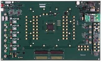

Semiconductor manufacturers constantly search for the best interconnect solutions to characterize the high-speed transceivers found on FPGAs. PCB (Printed Circuit Board)-mount SMA (SubMiniature version A) connectors are used in many situations to interface with test equipment and route signals found in modern transceivers. Figure 1 shows a Xilinx Spartan-6 FPGA SP623 characterization kit, which features several PCB-mount SMA connectors.
Figure 1: PCB-mount SMA connectors on the Xilinx Spartan-6 FPGA SP623 Characterization Kit (Image Source: Samtec)

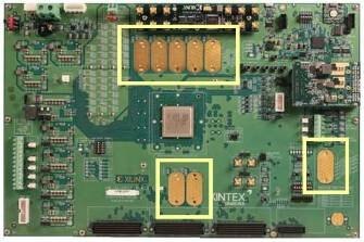

Bulls Eye has found an additional use on FPGA boards. Because it enables so much PCB real estate to be saved, the test head can be positioned closer to the device. Figure 4 shows a Xilinx Kintex UltraScale FPGA KCU1250 Characterization Kit with eight Bulls Eye pads (as highlighted).
Figure 4: Xilinx Kintex UltraScale FPGA KCU1250 Characterization Kit with eight Bulls Eye pads (Image Source: Samtec)

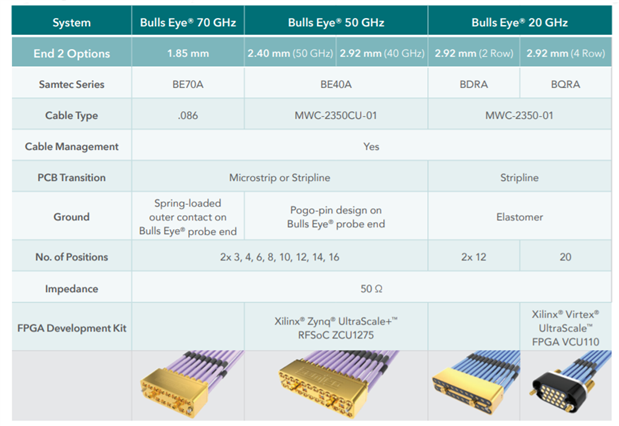

The Bulls Eye system has advanced from 20 GHz (BDRA and BQRA series), to 50 GHz (BE40A series), to the present 70 GHz (BE70A series) designs, with a system up to 90 GHz under development. Table 1 summarizes the Bulls Eye family from Samtec. The system has evolved in performance and flexibility, and is available in microstrip and stripline transmission solutions. The BE70A series proprietary cable design provides 360° grounding around a spring-loaded pogo-pin contact. In addition, the test assemblies furnish a 1.85-mm connection to instrumentation. The BE40A series is a 50 GHz double row system with signal and ground pogo pins. End 2 connectors are 2.92 mm and 2.40 mm, available in microstrip or stripline PCB transmission, and are backward compatible with legacy, double row BDRA series 20 GHz solutions.
Table 1: Bulls Eye Test Point System Cross Reference Guide (Source: Samtec)

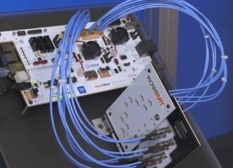

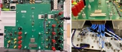

This application example is based on Samtec's 56 Gbps PAM4 product demonstration platform, and highlights the advantage of using the Bulls Eye High Performance Test System. A Credo Bald Eagle 2 retimer (Figure 5a) transmits QPRBS31 pattern signals at 56 Gbps PAM4 data rates on five separate channels. These signals run differentially through about 1.5" of PCB trace to the 70 GHz Samtec BE70A Bulls Eye High Performance Test System. The signals travel from the Bulls Eye connector through phased match pairs of Samtec low-loss microwave coax cable, terminated with 2.4 mm precision RF connectors. These connectors mate to a Samtec SI evaluation board with NovaRay extreme density arrays. The signals travel from the coax cables, through the evaluation boards and Samtec NovaRay connector set, through another set of high-performance precision RF 2.4 mm cables, and back to the Bulls Eye connector. Finally, the data lanes circle back to the Credo Bald Eagle 2 receiver, recovering the data.
Setup of 70 GHz high-performance test point system Results of demonstration
image image

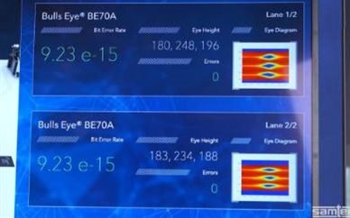

Figure 5a: Setup of 70 GHz high-performance test point system 5b: Results of demonstration (Image Source: Samtec)
Figure 5b shows the results. Specifically, there are zero errors, which is impressive for 56 Gbps PAM4 modulations. The Eye diagrams display signal amplitude with respect to time, and the resulting graphs resemble the shape of an eye. Increased noise will cause the eye to close, whereas, in an ideal scenario, the eye will appear wide-open. In the case of the Bulls Eye BE70A, the eye diagrams show eyes that are wide-open, with eye heights ranging from 180 to 248 mV, showing low Bit Error Rates (BER) of e-15.

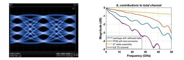

Figure 7: 106.25 Gbps PAM4 Tx measured Eye (left) and Channel IL breakdown (right) (Image Source: Signal Integrity Journal)
