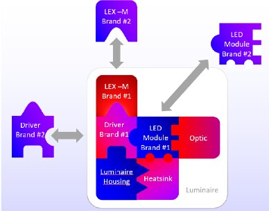

The popularity of the semiconductor-based light-emitting diode (LED) for lighting applications has grown exponentially in recent years. LEDs are energy efficient and offer comparable light quality to fluorescent and incandescent bulbs, but with longer life, added durability, and significantly reduced energy consumption. Manufacturers worldwide have developed LED luminaires; however, connectors and associated parts have largely remained proprietary, greatly increasing the risk of obsolescence. Realizing that this could present some limitation to the broad adoption of LED lighting, the Zhaga Consortium was created, of which Amphenol, along with other manufacturers, is a member, to create a set of common manufacturing standards for LED luminaires. This article presents an overview of the Zhaga Consortium and some of the LED lighting standards that have been released to date.
What is a Luminaire?
According to the Illuminating Engineers Society (IES), a luminaire is defined as “a complete lighting unit consisting of a lamp or lamps together with the parts designed to distribute the light, to position and protect the lamps, and to connect the lamps to the power supply.” The term luminaire can be used interchangeably with more familiar terms such as light fixture or light fitting.
Zhaga Consortium
The Zhaga Consortium is a global association launched in 2010 with the mission of creating standards for the lighting industry that ultimately simplify the design and manufacturing of LED luminaires. It comprises 360 member-companies, as well as a range of suppliers and testing labs.  The consortium's mission is to identify electrical, mechanical, communication, optical, and thermal interfaces for the interoperable components used within LED luminaires, with the goal of enabling compatibility, upgradability, and serviceability.
Zhaga membership offers many benefits; the key benefit is early access to Zhaga's roadmap, strategy, and proposals for new specifications, with influence over their development. Members also share intellectual property and the ability to certify products.
Figure 1: Illustration of the interoperability of a driver, connectivity module, and LED module within a luminaire. (Image Source:  Zhaga White Paper)

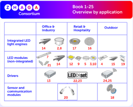

Overview of Zhaga Books
The Zhaga Consortium publishes the descriptions and specifications for LED standards in Zhaga Books. Rather than being presented as one single compendium, Books are published as a series, with each Book being exclusive to a specific application. For example, Zhaga Book 20 describes a smart interface providing a connection between a sensing/communication node and an indoor LED luminaire.
Figure 2: Zhaga Books 1-25 Overview by Application  (Image Source: Zhaga Consortium)

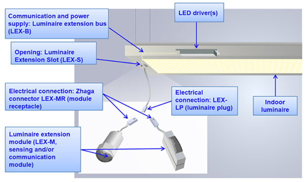

Zhaga Book 20 describes the specifications for a smart interface connecting a sensing/communication module to an indoor LED luminaire. Amphenol’s Book 20 FLM Series has been approved by the Zhaga Consortium as the Book 20 standard for connecting modules with the LED driver and control system.
Figure 4: An example application using Amphenol FLM series connectors
FLM Series connectors support the Digital Addressable Lighting Interface (DALI-2) protocol, a smart interface protocol that enables bi-directional communication between luminaires and modules. To enable the DALI-2 bus, Zhaga Book 20 specifies the 2- position connectors: the Luminaire Plugs (LEX-LP) mounted to the luminaire and Luminaire Extension Module Receptacles (LEX-MR) mounted to Book 20 compliant sensors or communication modules. DALI-2 support is essential for the Zhaga D4i certification, which itself is an extension of the DALI-2 certification. FLM Series connectors are available in Wire-to-Wire and Wire-to-Board configurations.
