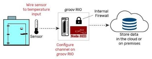

An example of an edge I/O device is the groov RIO module from Opto 22. It is an intelligent, Ethernet-based I/O unit that supports a wide variety of software-configurable I/O options. It can quickly and directly connect traditional wired switches and sensors to Ethernet networks, software applications, and cloud platforms without intermediary control or communication hardware, such as PLCs, PACs, or PCs. PoE (Power over Ethernet) is also supported. The groov RIO can be used in systems that already employ other control systems or completely stand-alone devices. Let's take a deep dive into the groov RIO's features and understand more about this edge I/O device.
Let’s See How the groov RIO Works
Groov RIO is an edge I/O module, with functionality falling somewhere between intelligent Ethernet I/O and a micro RTU (Remote Terminal Unit). Its primary purpose is acquiring data from sensors and switches; however, it can also run standalone, executing its own programs and control loops, similar to a controller. While it can’t do everything a controller can do, the groov RIO has functionality that a traditional controller does not, such as providing mobile HMI and interacting with network services.
The groov RIO provides a means to configure a large number of I/O very quickly. It provides eight channels of software-configurable multifunction, multi-signal I/O, as well as two mechanical relays. One device supports over 200,000 unique I/O combinations. Because the groov RIO replaces numerous devices in a traditional I/O system, costs can be reduced, as well as the time required for design and maintenance.
Groov RIO supports PoE; devices can be simultaneously supplied with low-voltage power and network connectivity via Ethernet. Additionally, the groov RIO has built-in security features, such as configurable device firewall, TLS certificate management, and segmented network interfaces. Native support for MQTT/Sparkplug B and other IoT tools such as Node-RED are included, enabling users to transport data directly from the edge to any other part of the organization without the traditional intermediary steps. If more I/O is needed, multiple groov RIO units can be joined securely.

Case Study #1: Granular Temperature Monitoring for an Automated Storage and Retrieval System (ASRS)
One system integrator was tasked with designing an automated system that collects temperature data from many points across a warehouse. The data is then directly fed into the customer’s Ignition SCADA system using MQTT. This monitoring system enables the proper storage of heat-sensitive items.
The traditional approach would have required installing and configuring PLCs and their I/O cards, along with power supplies and networking equipment in each location, and then programming the PLCs to perform the necessary functions. Additional gateways may have been required to support MQTT.
The simpler solution was to use groov RIO modules configured for temperature sensing. PoE supplied power to connected devices, eliminating the need for external power supplies.
