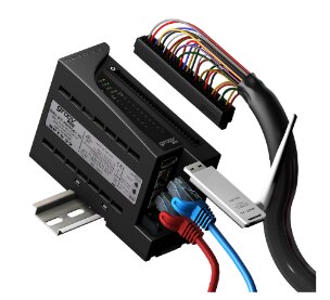

An example of an edge I/O device is the groov RIO module from Opto 22. It is an intelligent, Ethernet-based I/O unit that supports a wide variety of software-configurable I/O options. It can quickly and directly connect traditional wired switches and sensors to Ethernet networks, software applications, and cloud platforms without intermediary control or communication hardware, such as PLCs, PACs, or PCs. PoE (Power over Ethernet) is also supported. The groov RIO can be used in systems that already employ other control systems or completely stand-alone devices. Let's take a deep dive into the groov RIO's features and understand more about this edge I/O device.
Let’s See How the groov RIO Works
Groov RIO is an edge I/O module, with functionality falling somewhere between intelligent Ethernet I/O and a micro RTU (Remote Terminal Unit). Its primary purpose is acquiring data from sensors and switches; however, it can also run standalone, executing its own programs and control loops, similar to a controller. While it can’t do everything a controller can do, the groov RIO has functionality that a traditional controller does not, such as providing mobile HMI and interacting with network services.
The groov RIO provides a means to configure a large number of I/O very quickly. It provides eight channels of software-configurable multifunction, multi-signal I/O, as well as two mechanical relays. One device supports over 200,000 unique I/O combinations. Because the groov RIO replaces numerous devices in a traditional I/O system, costs can be reduced, as well as the time required for design and maintenance.
Groov RIO supports PoE; devices can be simultaneously supplied with low-voltage power and network connectivity via Ethernet. Additionally, the groov RIO has built-in security features, such as configurable device firewall, TLS certificate management, and segmented network interfaces. Native support for MQTT/Sparkplug B and other IoT tools such as Node-RED are included, enabling users to transport data directly from the edge to any other part of the organization without the traditional intermediary steps. If more I/O is needed, multiple groov RIO units can be joined securely.
Figure 3: Opto 22 groov RIO Edge Controller

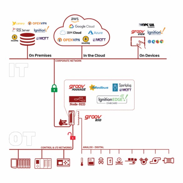

Groov RIO's embedded software and protocol support enable the secure exchange of data between the OT and IT worlds (Figure 4). The module comes pre-loaded with an array of industry-standard software tools. Also included is groov Manage, a web-based software for configuring groov RIO’s I/O channels, security, and communications. Once installed, the groov RIO can be independently managed and configured through this browser-based tool.
Groov Manage eliminates the need for a master control unit, and it features support for standard enterprise network services like DNS, DHCP, and VPN to facilitate network connectivity. Embedded communication options include efficient data publishing with MQTT Sparkplug, advanced signal processing, data aggregation, and transactions with databases and web services, using the low-code Node-RED environment and runtime.
Figure 4: groov RIO Architecture. Image Source: Opto22
