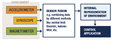

Sensor fusion technology is a solution to overcome the limitations of a single physical sensor. Here, the system acquires data from many different sensors and the overall data is analyzed using specific algorithms to provide the desired accurate and precise result.
We can define sensor fusion as a process (software) to combine data from multiple sensors that provide a more accurate picture of the object environment, rather than using information from a single sensor alone.  A smart phone is the most popular example of sensor fusion. In order to determine its location, the smart phone processor acquires data from three different sensors, the accelerometer, gyroscope, and magnetometer and combines it to provide the accurate geographical location of the phone.
Figure 1: Sensor Fusion Block Diagram
