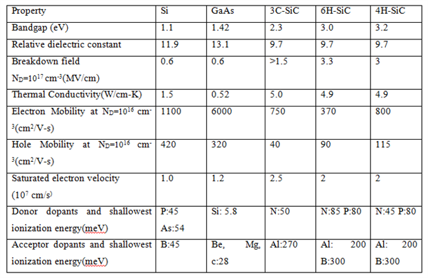

Being a wide bandgap semiconductor material, Silicon carbide (SiC) can operate at very high frequencies. SiC is not attacked by any acids or alkalis or molten salts all the way up to 800°C. It also has a very low coefficient of thermal expansion.  SiC has excellent mechanical properties like extreme hardness and low friction reducing mechanical wear-out. It exists in about 250 crystalline forms (called polytypes), out of which 3C-SiC, 4H-SiC, and 6H-SiC are the most common polytypes used in semiconductor devices. Each polytype exhibits unique fundamental electrical and optical properties are given in Table 1.
Table 1: Properties of SiC Polytypes
