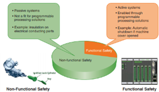

Functional safety is the study of methods and measures to reduce risk of harm to people and equipment when machines malfunction or when their operating environment is interrupted.
If we apply this definition to a game of football, referees have the ability and power to halt a game when they feel a violation occurs, but don’t always see everything and don’t always make the right call. These errors could make or break a game depending on which side of the field you’re on, so in ideal sporting world we could anticipate these erroneous calls and avoid them all together. Functional Safety seeks to address a similar issue in systems design, where the cost of error could be catastrophic or fatal, such as a machine failing to detect an open panel and causing injury to the human operator.
Essentially, Functional Safety design tries to anticipate ways that systems can fail, and when they do, implement Plan B.

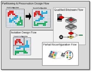

The ability to control system failure modes through fault-tolerant design requires an implementation methodology that ensures fault propagation can be controlled. Xilinx Isolation Design Flow (Figure on Left) provides fault containment at the FPGA module level, enabling single-chip fault tolerance.
