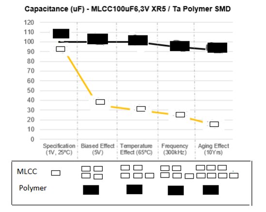

Comparison of a Polymer Capacitor and MLCC 1210
So let's compare the above characteristics of a polymer capacitor of the same rating to an MLCC (1210, 100uF, 6V). Figure 1 shows a comparison of these capacitors according to parameters such as voltage, temperature, frequency, and aging. This will begin to show us how to replace an MLCC with a tantalum polymer capacitor.
Figure 1: Comparison of an MLCC to a Polymer Capacitor

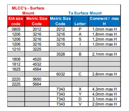

The process of converting from an MLCC to a Polymer SMD component is not a one-to-one method and needs to follow several considerations. The first step is to make a mechanical and dimensional match, which Table 1 illustrates. MLCC EIA codes 0805 and 1206 have a direct dimensional footprint alternative with metrics P-2012 and A-3216 footprints. The larger MLCC EIA codes 1210 and 2220 have a potential option with metrics B3528 and D7343 footprints, although the replacement is not direct.
Table 1: Dimensional Matching: MLCC vs. Polymer SMD Capacitor

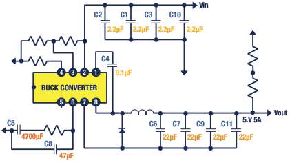

Application Example: Buck Converter in an Automotive Application
Figure 2: Buck Converter
Input Side
In the above circuit, C1, C2, C3, and C10 are the input side capacitors, and they have a same capacitance value of 2.2uF with rated voltage 50V in a 1206 X7R package. There is not a drop-in replacement for each capacitor, but we can take the total 8.8uF capacitance and replace the four ceramics with one 10uF 35V KO-CAP if ESR, Leakage, and frequency are not of a concern on the input side. It is more than the original capacitance we need, but it is still within the required range for this regulator.
Output Side
On the output side, there are four capacitors C6, C7, C9, and C11 that have the same capacitance value of 22uF with 10V rated voltage in X7R 1206 package. In this case, there is a drop-in replacement in T520 series of KO-CAP with a 6.3V rated voltage which is more than the output voltage range. In this replacement, the KO-CAP ESR is higher than the ceramic equivalents, but that comes within the design specification. This circuit operates on the 300kHz frequency, and series resonant frequency of the replacement is around 1Mhz making it a better solution.
Capacitor C4, C5, and C8 are used to support the functionality of the device, and there is a suitable replacement in KO-CAP by both their size and capacitance value. We are not considering the leakage current because it is a concern of circuity where we use fixed non-rechargeable batteries.
