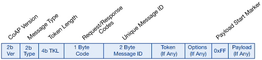

Frame Format
CoAP messages are encoded in a simple binary format including a 4 Byte header, Token, Options, and Payload. For any type of message, the header is compulsory since it may contain Token or Options or Payload. Different fields in a CoAP message are:
CoAP Version: (2 Bit) is a part of the fixed header and defines the version of the CoAP used.
Message Type: (2 Bit) defines the type of the message.
0: Confirmable (CON)
1: Non-Confirmable (NON)
2: Acknowledgement (ACK)
3: Reset (RST)
Token Length: (4 Bit) indicating the length of the token variable which can be up to 8 bytes.

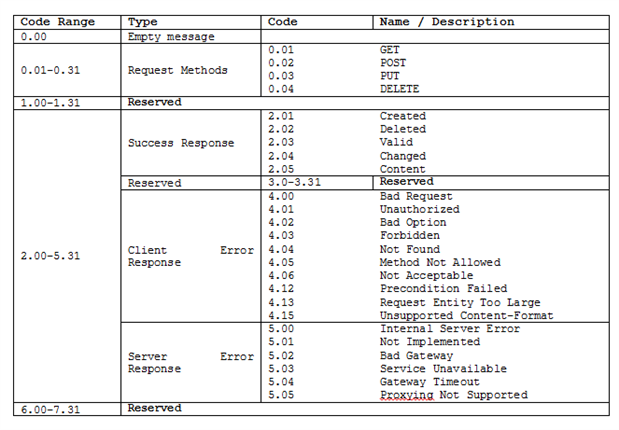

Request/Response Code: (1 Byte)   c.dd split into class c of 3 bits and details dd of 5 bits.
Table 1: CoAP Method and Response Codes
Unique Message ID (2 Bytes): is a 16-bit number in the network byte order. It is used to detect message duplication. Message ID is also used to match messages of type Acknowledgement/Reset to messages of type Confirmable/Non-confirmable.
Token value is used to correlate requests and responses. Every request carries a client-generated token that the server MUST echo without modification in any resulting response. A token is intended for use as a client-local identifier or a Request ID for differentiating between concurrent requests. The client should generate tokens in such a way that tokens currently in use for a given source/destination endpoint pair are unique.
Options follow Tokens. Both requests and responses may include a list of one or more options. Options are used to provide Information like URI and payload media type. CoAP defines a single set of options that are used in both requests and responses like Content-Format, ETag, Location-Path, Location-Query, Max-Age, Proxy-Uri, Proxy-Scheme, Uri-Host, Uri-Path, Uri-Port, Uri-Query, Accept, If-Match, If-None-Match, and Size1. Not all options are defined for use with all methods and response codes.
Payload can be a representation of resource or result of a requested action and is the primary content or data. The content format is specified by the internet media type, which can be plain-text, XML, Json etc.  Diagnostic payloads explain the client-server error in human readable format and do not have the content-format option. Packets containing information like ACK, RST do not need payloads.  A special byte 0xFF marks the end of the options and start of the payload.
