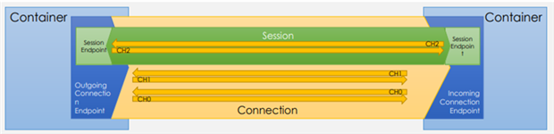

Before the communication starts, a Connection is first established between Containers on top of any transport stream and required security implementation like TLS and SASL (Defined in Security Layer). Containers Communicate using Connections, and consists of Full-Duplex reliably ordered sequence of Frames. Connections manage the transfer capacity by defining maximum Frame size. Container acting as a client initiates the negotiation for maximum frame size. After the establishment of a connection and exchange of protocol header between the peers, each peer relays an open frame in the channel with info like capabilities and limitations of the peer and maximum frame size to open a Connection. After the exchange of open frame, peers communicate in mutually acceptable limitations. An AMQP connection consists of a negotiated number of multiple unidirectional Channels in either direction. Frames are marked with channel number indicating its parent Channel, and the Frame sequence for each Channel is multiplexed into a single Frame sequence for the Connection. The connection is closed with the transfer of a close frame. The close frame indicates the reason for closing the connection and is the last frame in any Connection. The close Frame is usually exchanged in Channel 0 but not restricted.
Sessions correlate two unidirectional channels to form a bidirectional sequential conversation between containers. A single Connection may have multiple independent Sessions simultaneously. Multiple sessions can be used for different activities like data transfer, control messages, etc.

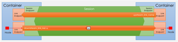

An AMQP network is consist of Nodes connected by unidirectional routes namely Link. Any peer communicating can create links in any direction. Links are named by applications and carry payloads only in one direction, but the communication is bidirectional as there also communication of flow control like error message also happens from receiver to sender. To have a full-duplex bidirectional data transfer, nodes can create two links in the opposite direction. Links are connected to nodes at Terminuses which are either Source or Target. Source and target terminus tracks outgoing and incoming messages respectively. The primary responsibility of a Terminus is to maintain a record of the status of each active delivery (unsettled deliveries) attempt until it is safe to forget.
A single Session may be simultaneously associated with any number of Links, but a Link is attached to at most one Session at a time. Message transferred on a Link are sequentially identified within a Session. Sessions are established by creating a Session Endpoint and assigning any unused channel number. A begin frame announces the association of the Session Endpoint with an outgoing channel. A Session ends automatically when the Connection is closed or interrupted.
Both Connections and Sessions are modeled by each peer as endpoints that store local and last known remote state regarding the Connection or Session in question. Sessions provide the context for communication between Sources and Targets. A Link Endpoint associates a Terminus with a Session Endpoint. Within a Session, the Link Protocol is used to establish Links between Sources and Targets and to transfer Messages across them.
