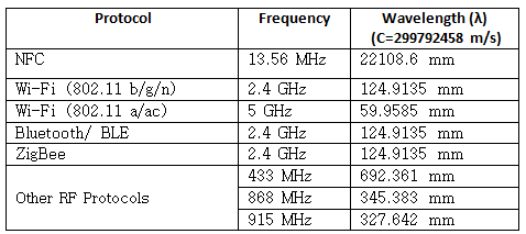

Learning the wireless standard or protocol used by the transceiver is important in selecting the matching antenna.  Each wireless standard uses different operational radio frequencies for communication. Antenna sizes vary proportionally to the wavelength (λ).
Some popular short and medium range wireless protocols and their respective frequencies are:
Other protocols include LTE (cellular), GNSS (GPS), and various sub 1GHz ISM protocols such as LoRa.

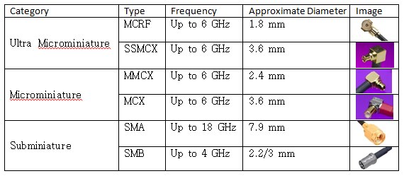

For Cabled Antennas, RF transceivers / modems are coupled to the antenna by using the appropriate connector. In some instances, if your RF transceiver / modem is provided as a full assembly (e.g., daughter board), the connector on the PCB will already be pre-selected. However, if you are using a chipset and need to place the connector, then you need to be careful  to avoid signal losses, which can result when there is a mechanical mismatch or a loose-fitting antenna, making the choice of a connector very important. A list of commonly available connectors is given below.
Press-fit connectors come with a limited mating cycle, hence, you have to avoid repeated detachment and attachment of these connectors.  Note, the orthomode transducer (OMT) common connectors for many small device manufacaturers is the MCX – which looks a lot like the MMCX or other connectors. Be very careful to know what connector is specified and what type is provided on the other end, so you have the correctly mating conectors.
Finally, in applications were RF performance is key and there is concern of an impedance mismatch, it may be necessary to include or optimize the RF matching network on the PCB, to match the characteristic impedance of the connectors of the device and the antenna. Any mismatch in impedance can result in a reflection loss.  Basic details on the matching network parameters should be available on your Antenna Applications Specification, or if not or under special circumstances, you may need to turn to an RF expert to help you design an optimally matched network.
