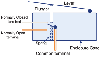

A limit switch is an electromechanically operated switch. It changes state when an object comes into physical contact with its actuator. It makes or breaks the electrical connection to indicate the state of the switch contacts. The switching action generates a signal which helps to control electric supply to the machine. Figure 1 shows the architecture of a limit switch and its components.
Figure 1: Limit Switch Architecture
  • Enclosure Case:  This is a metal or plastic enclosure for protecting the limit switch components.
  • Terminals:  Limit switches have three terminals, Normally Closed, Normally open and Common terminal.
  • Spring: This mechanical arrangement is used to reset the switch position.
  • Actuator: This is a combination of plunger and lever. The actuator physically comes in contact with objects. The actuator translates a linear or rotary action into an electrical signal. Different types of actuators  are available to have proper mounting and orientation with the moving parts.
