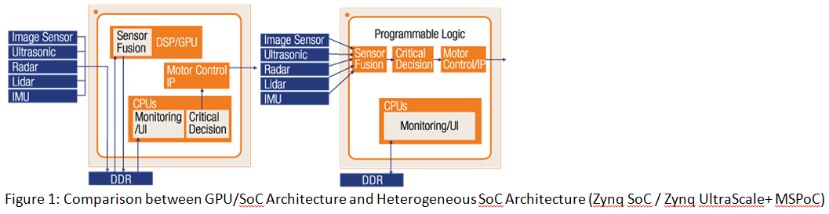

One solution which can address the performance, power, and security requirements is the use of a heterogeneous System on Chip such as Xilinx Zynq SoCs or Zynq UltraScale+ MPSoCs, which combine processors with programmable logic. Often these devices will contain both application and real-time processors along with the programmable logic (See Figure 1).
This tight coupling of logic and processors allows for the creation of a system which is more responsive, reconfigurable, and power efficient. A Traditional CPU / GPU based approach requires the use of external memory from one stage of algorithm to the next. This reduces determinism and increases both power dissipation and latency.
Using a Heterogeneous SoC enables a deterministic response time with a reduced latency. The programmable logic also offers a very efficient implementation, when considering the MIPS/Watt.

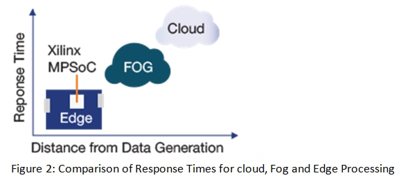

  • Cloud Processing – In cloud processing, the data is transferred back from the edge for processing. Cloud processing applications have a longer response time than edge processing applications (See Figure 2). Example applications include Voice Controlled Home Automation where delays in response acceptable.
  • Fog Processing – In Fog processing, the process node is located closer to the edge node which is gathering the data, typically the processing node is located on a Local Area Network (LAN). One example application would be an Industry 4.0 manufacturing solution which processes manufacturing test results.
