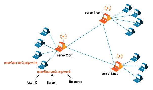

XMPP technologies use a decentralized client-server architecture related to the architecture used for the World Wide Web and the email network. In decentralized client-server architecture, client developers can focus on user experience, and server developers can focus on reliability and scalability. It is much simpler for organizations to manage than a purely peer-to-peer technology. It is a high availability system because the full system does not have a single point of failure, and the servers can implement important security plans such as channel encryption, user authentication, and prevention of address deceiving.
As XMPP communications happen on a network, it needs an address. This address is known as a Jabber ID (JID). XMPP typically depends on the Domain Name System (DNS) to deliver the underlying structure for addressing, instead of using raw Internet Protocol (IP) addresses. Every Jabber ID contains a domain portion which maps typically to a fully qualified domain name (FQDN). The domain portion of a JID is case-insensitive for ASCII characters.
Figure 1: XMPP Architecture
For virtual identity on the network, a Jabber ID is chosen to create an account at XMPP service. It might be possible that Jabber ID is assigned automatically. Jabber ID looks similar to an email address. It can also be the same as email address, depending on the deployment policies. For example, Google Talk on the XMPP network looks the same as the Gmail addresses of users. The user portion of the JID is case insensitive.
When anyone connects itheir client to an XMPP server, a resource identifier for that particular connection is assigned by the server or might be chosen by the user. This resource is used for routing traffic to that connection. It is independent of any other connection that is opened at that moment. The resource is added at the end of the user account address and enables query or exchange messages with a particular device that is associated with the specific account. The resource can be any string, and often the name of the computer, location, or the client software that has been used. The resource portion is case-sensitive.
