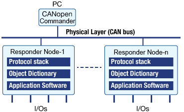

Network Architecture
All CANopen device manufacturers follow the same standard which helps to interface devices from different manufacturers into one network. Figure 1 shows the block diagram of a CANopen network architecture.
Figure 1: CANopen network architecture
Physical layer (CAN bus): The CANopen physical layer consists of a CAN-H and CAN-L channels to transmit the differential signals. The industrial standard CANopen physical layer includes the power bus that provides the required power to all devices in that network. The CAN bus physically connects the commander and responder devices and supports all network topologies. The CANopen devices support 9-pin D-sub connector, 5-pin mini style connector, and the multi-pole connector.
Commander node: CANopen commander node is the commander of the CANopen network, and is responsible for data communication, synchronization, and network management. A single CANopen commander can communicate with up to 127 responder devices in a network. A CANopen commander can be implemented on a single board computer (SBC) or Personal Computer (PC), with a commander interface card for hardware connectivity with the network. An Application Program Interface (API) is used to communicate with the CAN open hardware and its peripherals. An Electronic Data Sheets (EDS) file is used to specify the supported Object Dictionary (OD) entries and node identification numbers (ID). A CANopen commander library helps to build a CANopen commander system quickly and easily.
Responder node: The CANopen responder device performs tasks, specified by the commander. Usually, the responder node drives the control devices such as barcode readers, RFID readers, actuators, sensors, and human-machine interfaces. Each device has a unique device identification number that helps to address the individual responder-node in the network. The acceptance filter has to be implemented in a responder node to filter the messages. These devices respond to the request message, addressed to its ID or broadcast messages.

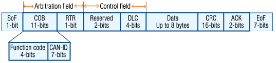

CANopen Frame Format
CANopen frames are structured using "dominant" bits (logic 0) and "recessive" bits (logic 1). It is similar to the CAN frame format.  Figure 2 illustrates the CANopen message frame format.
Figure 2: CANopen frame format
Start of Frame (SoF): The message frame starts with one dominant bit which is used to synchronize the network devices.
Communication Object Identifier (COB-ID): COB-ID is a header of the CANopen message. It includes function code and a CAN Identifier. The function code represents the type of communication (NMT, SYNC, EMCY, PDO, and SDO) and kind of action needed to be performed using the data fields. The CAN Identifier (CAN-ID) is used to address the nodes in the network.
Remote Transfer Request (RTR): This bit is used to represent the data frame or arbitration frame. The commander controller uses the arbitration frame to take control over the CAN bus. The data frame is used for a message transaction between the nodes.
Data Length Code (DLC): It represents the data length information of the transmitted message.
DATA: This field holds the actual message or index address of object types.
Cyclic Redundancy Check (CRC): It helps to identify the bit error in the message frame.
Acknowledgment (ACK): It represents the status of the transmitted message. If the message is successfully sent, the acknowledgment signal becomes dominant. For transmission failure, the ACK becomes recessive.
End of  Frame (EoF): The seven consecutive recessive bits represents the end of the frame.
