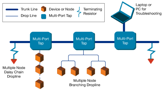

DeviceNet uses Trunk Line and Drop Line topology for communication. The Trunk Line is the network cable between two terminating resistors which connects the nodes and taps. The Trunk Line uses DeviceNet Thick cable, which carries maximum current. Drop Line is the non-terminated network cable, which connects the node to the trunk.
Trunk Line and Drop Line topology reduces troubleshooting time by allowing hot plugging, providing ease of wiring and accessibility through multiple taps. The topology allows signal and power on the same wire. The possible variants of Drop Line topology are shown in Figure 1.
Figure 1: DeviceNet Network Topology

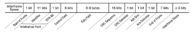

DeviceNet uses the standard CAN data link layer (unmodified) for efficient message handling. It requires less network bandwidth to transmit CIP messages over DeviceNet. Figure 2 shows the CAN Data frame format.
Figure 2. CAN Data Frame Format
When the start of frame is sent, all receivers change their state from recessive (logic 1) to dominant (logic 0). The 11-bit identifier and remote transmission request (RTR) bit together make the arbitration field. This arbitration field provides frame priority. The control field contains the length of the data field. The data packet size is 8 bytes. The cyclic redundancy check (CRC) detects frame error and frame formatting delimiters.

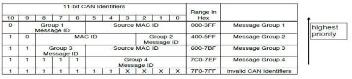

In general, three types of messages are exchanged between DeviceNet nodes. These messages use message groups 1, 2 and 3, whereas group 4 is reserved for future modifications.
Figure 3. Message Group Arrangement of DeviceNet
Because of the CSMA/CD and NDBA (Carrier Sense Multiple Access/Collision Detection with Non-Destructive Bitwise Arbitration) bus access method of the CAN protocol, message group 1 has the highest priority for bus access control. The smallest CAN identifier number has top priority. Devices using message group 1 and 3 also arbitrate on message ID. In message group 2, a device with a lower MAC ID wins the arbitration when a bus connection occurs. The DeviceNet data packet has an 11-bit address header. DeviceNet is designed to process many short data packets, to improve network access latency.
