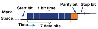

UART Character Transmission: Figure 1 shows the timing diagram of a UART. Each block represents a single bit which can be a mark or space. Mark is logic high while space is logic low.
Figure 1: Timing Diagram of a UART
The bit travels with fixed time rate given in bits per seconds. This is known as the baud rate. The latter indicates how many times the lines can change state (high or low) per second.  The most common baud rate is 9600 bits per second. The baud rate determines how fast data travels through the bus.
The transmission starts with the low bit which is seen by the receiver. It then sends out the data bits with the least significant bit first. The data bits can be 7 or 8 bits and are synchronized with the receiver. The 8th bit can be used by the receiver to check transmission error.  It is also known as the parity bit. The parity can be even or odd. If the parity is set to be even and the sum of the number of 1’s in the data is even, then the parity bit gets set to zero.  If the number of 1’s is odd then the parity bit is one. Similarly, if the parity is set to odd, and the number of 1's in the transmitted data is even, then the parity bit is set to zero.  In any other condition, it is set to one.

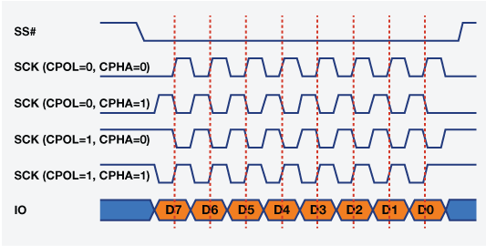

The SPI bus Modes are of 4 types as shown in Table 1. This mode depends on the polarity (CPOL) and phase (CPHA) of the clock signal. CPOL provides the default value of the signal which can be either high or low, and CPHA gives the edge on which the clock data is sampled, i.e. the rising or falling edge.
ModeCPOLCPHA
000
101
210
311
Table 1: SPI mode definition
In mode 0, data transmission occurs at the leading or rising edge of the clock, where the clock polarity is low. In mode 1, data transmission occurs at the trailing or falling edge of the clock, where the clock polarity is low. In mode 2, data transmission occurs at the leading or falling edge of the clock, where the clock polarity is high. In mode 3, data transmission happens at trailing or rising edge of the clock, where the clock polarity is high. Figure 2 shows the SPI bus timing diagram.
Figure 2: SPI bus timing diagram

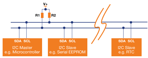

Figure 3 shows the block diagram of the master and slave devices.
Figure 3: I2C: Block Diagram of the Master and Slave Devices
The Master are those nodes which generate a clock signal and initiate communication.  The slave nodes receive the clock and responds to the master. In I2C, multiple masters and slaves can be connected. I2C uses open drain connections. The resistors shown in Figure 3 are pull up resistors that connect to the VCC lines.
