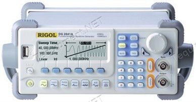

imageFunction Generator:
A function generator can make a signal of your choice so you can create a sine wave, square wave, and triangle wave. Some newer units even let you define any shaped waveform on your computer to be downloaded to the function generator, which is called the 'Arbitrary' or 'ARB' function.  These units are brilliant at giving you complete, easy control over a waveform that can be used to test a circuit.  Want to see how your filter performs?  Use a function generator as the input so you can vary the input frequency!
The latest entry-level units that can make ARB waveforms are designed are as glorified Digital-to-Analog converters.  The microcontroller tells the A/D chip what waveform to make, and then the output circuitry sends the signal out at the desired amplitude. The biggest error that users find when using a function generator is that its output is not very powerful.  It is easy to load it down when trying to drive something similar to an 8 ohm speaker.  Even when driving a 500 ohm resistor, your programmed output amplitude might be loaded down, giving a lower-than-desired signal output.
When buying a unit one should be concerned with the type of waveforms that it can output, the range of output voltages, and noise.  It is difficult to nail down an exact spec on output impedance, which tells you how easily it can be loaded down.  To cope with this variation, designers have a '50-ohm' mode, which makes the assumption that your load is exactly 50 ohms.  It costs about $200 to get into the function generator game, with the entry-level ARB models starting at around $400.

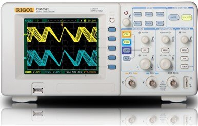

imageOscilloscope:
An oscilloscope is similar to a volt meter except that it draws a picture of what the voltage level is over time instead of displaying a voltage on a slow-changing 7-segment display.  This is the piece of equipment that is always shown in the movies to make a bench look serious.  The goal with an O-Scope is to be able to actually SEE what a signal is doing. What is the rise time of that signal?  Are there blips? Any noise? What frequency is the noise at?  Scopes are great for answering these questions since it is a live graph with time as the X-axis and voltage as the Y-axis.
Oscilloscopes are particularly useful because you can zoom out on a signal to look at the entire waveform, or zoom in to take a close look at the exact point where a sine wave crosses from negative voltage to positive voltage.
When buying a scope, the most important spec is the 'speed'.  A 100MHz scope is advertized as being able to resolve signals up to 100MHz (although one would want at least 2x headroom, so a 100MHz scope is really only good for 50MHz signals).  A scope is not an accurate way to measure absolute voltage so it is not a concern, but the noise is another big deal since you don't want to see a ton of noise that isn't really on your circuit.  It is possible to get into a reasonable scope for about $200.
