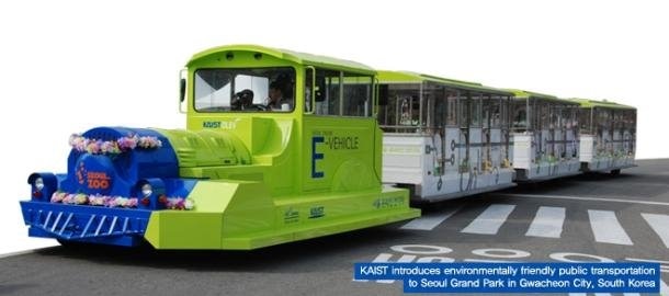

Electric bus/train powered by the road. (via KAIST)
Meanwhile in South Korea, wireless power transfer in roads is being tested by the Korea Advanced Institute of Science and Technology (KAIST). Their concept works off the principles of inductive charging. However, in this case, it is only charging for a fractions of a second.
In a micro-charging scheme, as the EV passes over of the magnetic coils in the road, it makes a quick power transfer connection. Multiply that by the thousands of coils embedded in the road, and a significant amount of power is transferred. The slower the EV moves, the more power is collected.
Even at highway speeds, the roads are able to deliver 30 kW at an average of 80% efficiency. Which is similar to the Japanese team's transfer loss. However, living creatures can touch the charging coils embedded in the road without receiving a shock. On the positive side, the Korean system could be installed now for about $1.5 million USD per mile.
The bus/train using the Korean system is being tested at the KAIST University.
