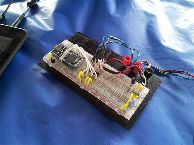

I also saw their latest prototype which uses the ARM Cortex-M3 mbed dev board along with a Microchip CAN transceiver:
