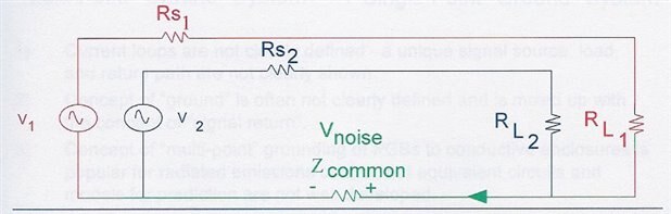

Occasionally grounding causes a noise problem in the form of ground loops (also known as “common impedance noise coupling”).  Often people are vaguely aware that ground loops involve noise from the ground resulting from multiple ground connections.  Here is a model to understand ground loops.
Suppose you have these two systems: The red system and the green system
Notice the red system has its return connected to ground at both ends.  On the green system the signal return line is connected to ground at the load but not at the source.  The resistance of the ground is not zero, so currents on the ground will develop voltages.  Current on the ground  could affect the red system by making the return reference different between the source and the load.  Such current will not affect the green system because its return path is grounded at a single point.  If the green system’s return path were connected at both ends, return currents from the red system could interfere with the green system.
A schematic drawing of this shows why it is called “common impedance coupling”:
Currents are shared among the desired return path and ground according to their impedances.  The return wire has a much lower impedance at high frequencies, so the ground does not carry high-frequency currents, and therefore high-frequency noise does not get into a system by ground loops.  Crosstalk that is worse at lower frequencies points to a ground loop.
