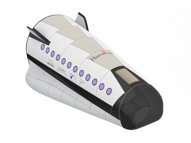

The implementation of a cabin escape system for a hypersonic aircraft is challenging on several levels: integration within the larger launch vehicle, load factors for passengers, the ejection propulsion concept, the capability to withstand an extreme thermal environment (the thermal protection system is a critical component of any trans-atmospheric flight system as re-entry into the atmosphere creates tremendous heat due to a combination of compression and friction with atmospheric molecules) and adaptability to a wide range of abort scenario conditions (low and high speed and different altitudes).
Any successful approach to a hypersonic flight escape system will require breakthroughs in current technologies in the area of control, structures, aerothermodynamics and other systems. Researchers have come up with an innovative morphing concept based on an inflatable vehicle sidewall and deployable rudders. The concept, funded by the EU and called HYPMOCES (for Hypersonic Morphing for a Cabin Escape System) is being worked on by a consortium composed of four main partners from four different European countries: Deimos Space S.L.U.(Spain),  DLR (Germany), AVIOSPACE (Italy) and ONERA (France).
The multi-phase nature of the return flight makes morphing an attractive solution for a hypersonic escape system. The abort scenarios cover a wide range of flight conditions and the integration within the mother spacecraft requires compact solutions in terms of shape. Thus,  a single shape cannot provide adequate performance and can be challenging with regard to the wellness of the ordinary passengers expected in the cabin. An increase of the lifting capability after ejection of an escape capsule and the increase of aerodynamic control surfaces is considered a strong requirement in order to safely return the passengers and crew.
A large cabin escape system able to change its shape and automatically reconfigure during an abort event after ejection will balance the compromise between the constraints for integration within the mother aircraft (compactness), the adaptability to the unpredicted environment in case of abort and the required flight performance to ensure safe landing.
