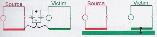

Conductive Coupling: There must be two wires between the aggressor and victim.  If there are no wires or only one wire between the source and victim, you can rule out conductive coupling.
The above circuits cannot experience conductive coupling because there are not two conductors connecting them.  .
