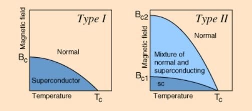

Prior thoughts on the Critical Magnetic Field. It is the nature of superconductors to exclude magnetic fields (Meissner effect - When a material makes the transition from the normal to superconducting state, it actively excludes magnetic fields from its interior) so long as the applied field does not exceed their critical magnetic field. This critical magnetic field is tabulated for 0K and decreases from that magnitude with increasing temperature, reaching zero at the critical temperature for superconductivity. The critical magnetic field at any temperature below the critical temperature is given by the relationship (via GSU)
