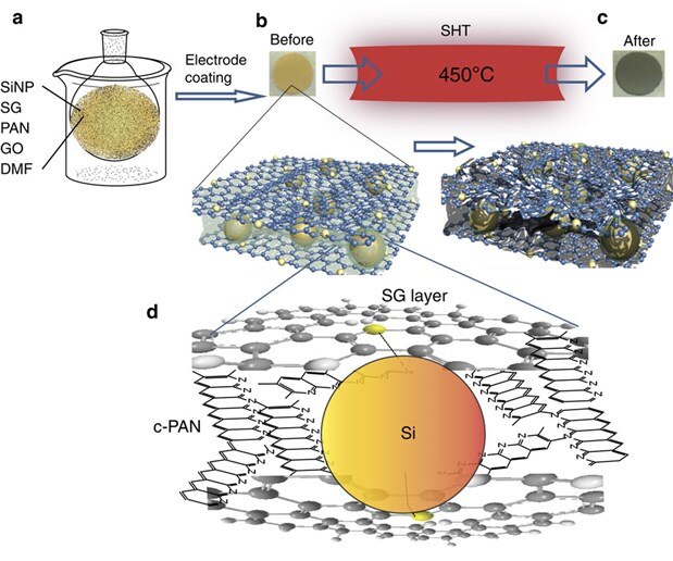

Schematic of electrode process design: (a) Components mixing under ultrasonic irradiation, (b) an optical image of the as-fabricated electrode made of SiNP, SG and PAN, (c) the electrode after SHT, (d) Schematic of the atomic scale structure of the electrode. (Source: Nature Communications 6, article 8597).

The most critical challenge the Waterloo researchers faced when they began producing batteries using silicon was the loss of energy that occurs when silicon contracts and then expands by as much as 300 per cent with each charge cycle. The resulting increase and decrease in silicon volume forms cracks that reduce battery performance, create short circuits, and eventually cause the battery to stop operating. To overcome this problem, Professor Chen’s team along with the General Motors Global Research and Development Center developed a flash heat treatment for fabricated silicon-based lithium-ion electrodes that is said to minimize volume expansion while boosting the performance and cycle capability of lithium-ion batteries. Professor Chen stated that the economical flash heat treatment created uniquely structured silicon anode materials that delivered extended cycle life to more than 2000 cycles with increased energy capacity of the battery.
