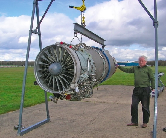

Project Quicksilver. The design of this British challenger relies on a modular construction with the main body consisting of a front section with a steel space frame incorporating the engine, a 35,000 hp Rolls-Royce Spey Mk.101 turbine (photo above), and the rear section a monocoque extending to the tail. The front sponsons are also modules, one of which contains the driver. The effort is managed by Nigel Macknight a professional writer who has authored articles and books with subjects ranging from the Space Shuttle to Formula 1 racing cars and the Tomahawk cruise missile. Macknight will also take the controls of the craft for its trials, development runs and record attempts. In the past he has involved himself in many of his subjects, competing in kart racing and Formula Ford motor-racing for seven years and participating in high-performance flights with some of the world’s top pilots, including NASA test pilot Ed Schneider and British Aerobatic Champion Iain Weston.
