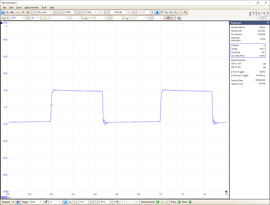

Stability, square wave drive 1kHz into 8R//2uF Kenwood AG-204D signal generator
Summary
The updated Mullard amp performs pretty much as the spec indicates. Its not up to modern HiFi standards but bearing in mind that the design is 50 years old that isn’t a surprise.
