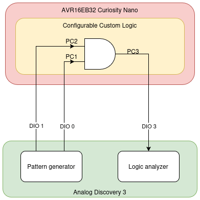

Today, I decided to check the pattern generator and logic analyzer features of the Analog Discovery 3. I have used a Microchip development board from the Curiosity Nano series with AVR16EB32 MCU, as a device under test unit. The AVR16EB32 MCU has support for configurable custom logic, which I configured to a simple AND gate, which uses PC1 and PC2 pins as inputs, and a PC3 pin as output. At the input of this gate was provided a pattern generated by a pattern generator and the output was captured by a logic analyzer. Below there is a block diagram of the setup that was performed during this test.

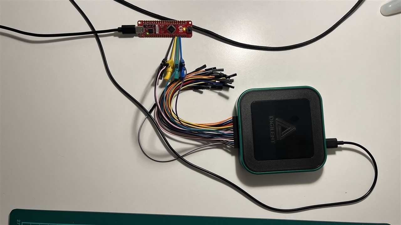

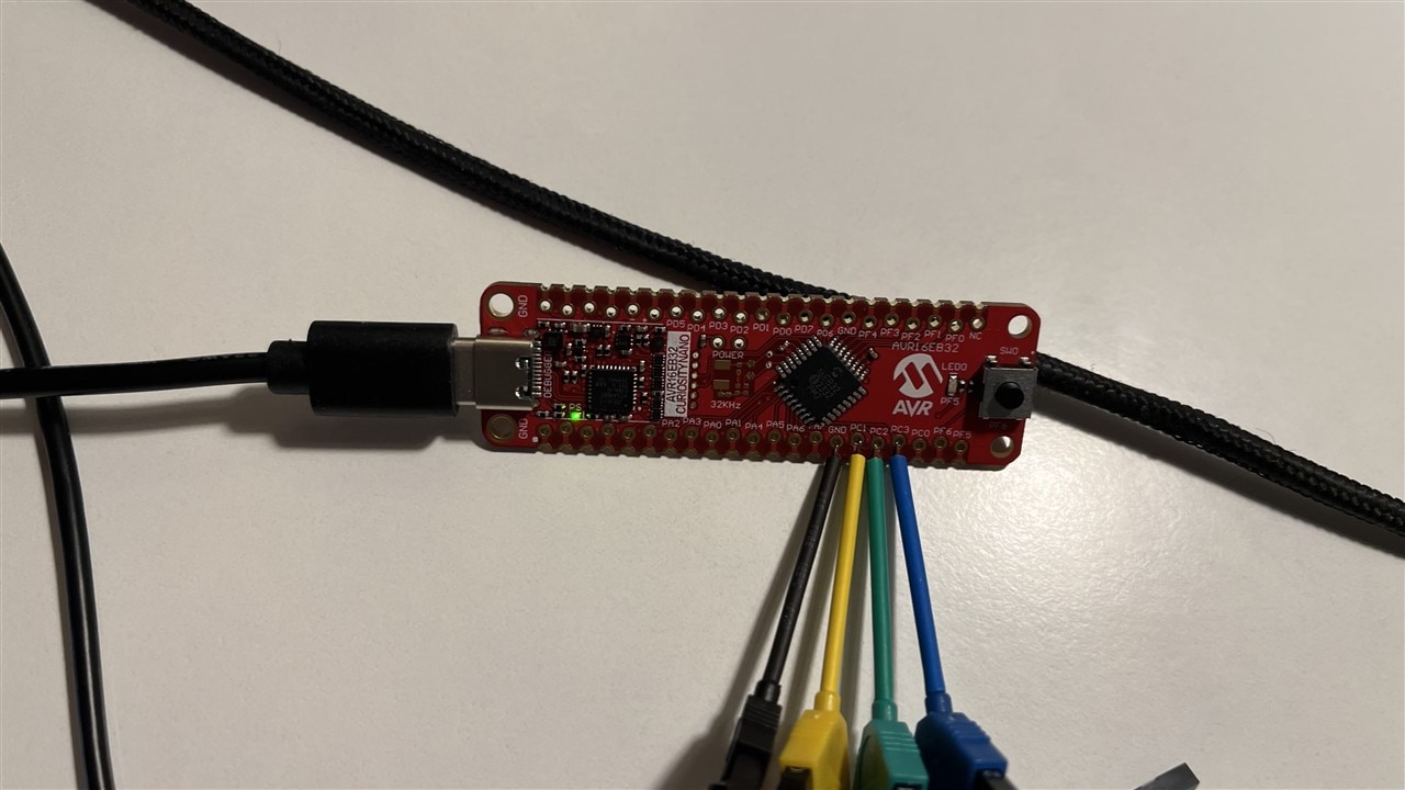

Here is a connection setup to the Curiosity Nano board:

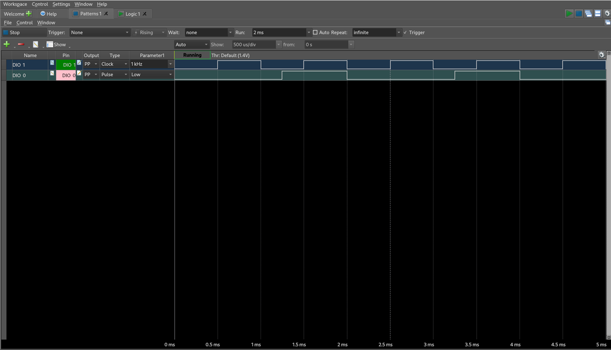

In WaveForms, I have created a pattern that uses DIO 1 and DIO 0 pins. The DIO 0 was configured as a clock type with a frequency of 1 kHz, while DIO 0 as a pulse with low to high transition. The created pattern was run in infinite mode. Below is a screenshot of this configuration.
The logic analyzer was configured to capture the DIO 2, DIO 1 and DIO 0 pins. It was configured for single shot capture. Below there is screenshot:
As presented in the attached screenshot, the configured AND gate in AVR16EB32 MCU worked properly.
