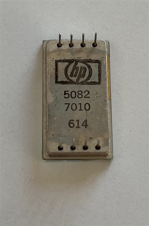

Some time ago, I occasionally bought an HP 5082-7010 LED display, which I did not have time to test if working properly. Today I decided to do this with the help of Analog Discovery 3.

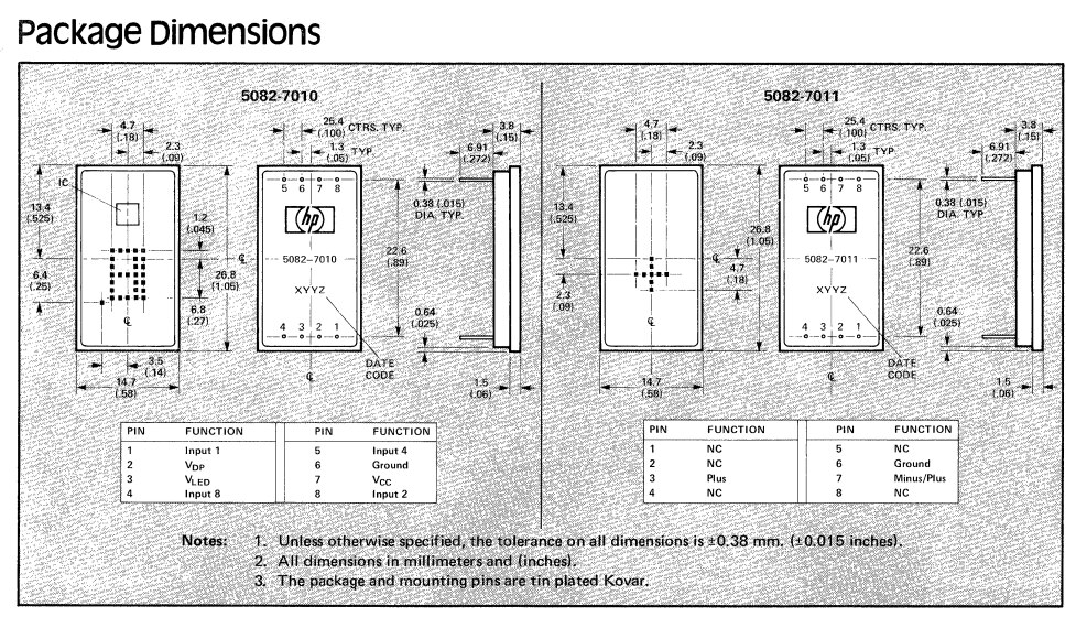

The HP 5082-7010 is a single-digit red LED numeric display module with a built-in BCD decoder/driver. It uses a 5×7 dot-matrix to display digits 0–9 directly from binary-coded decimal inputs, making it easy to interface with digital systems. Designed in a hermetic, rugged package, it is suitable for military and industrial environments, offering TTL compatibility and adjustable brightness. Below there are dimensions and pinout specification:

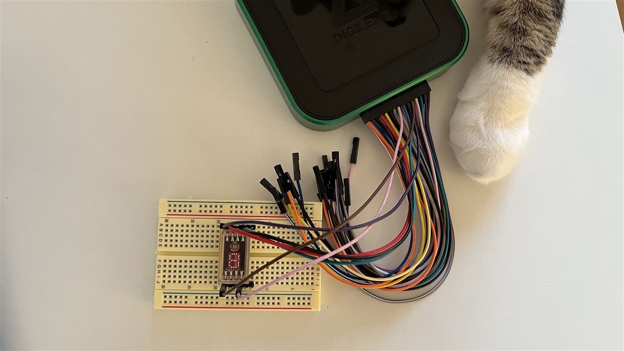

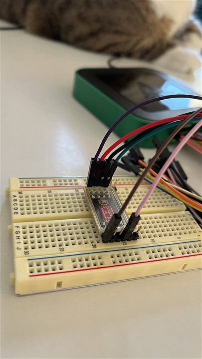

So, for a quick test, it is required to connect VCC, Vled, GND and Inputs 8,4,2,1. I have decided to make that connection on breadboard and connect to the Analog Discovery 3. The VCC together with Vled was connected to the V+ of Analog Discovery 3. And the Inputs 8,4,2,1 respectively to the DIO 0,1,2,3 on Analog Discovery 3.

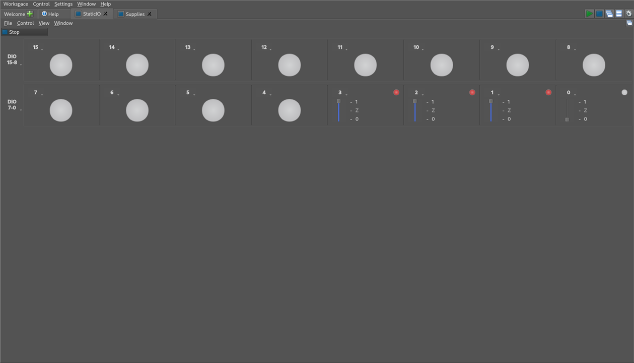

I have used WaveForms Supplies to provide 5V for VCC and Vled and StaticIO to display digits. Under StaticIO I have configured pins 0,1,2,3 as switches with Push-Pull mode.
Thanks to that, I was able to quickly test all characters. Additionally, if needed, with usage of Script mode, it is possible to run automatic tests in case of more display modules to test.
