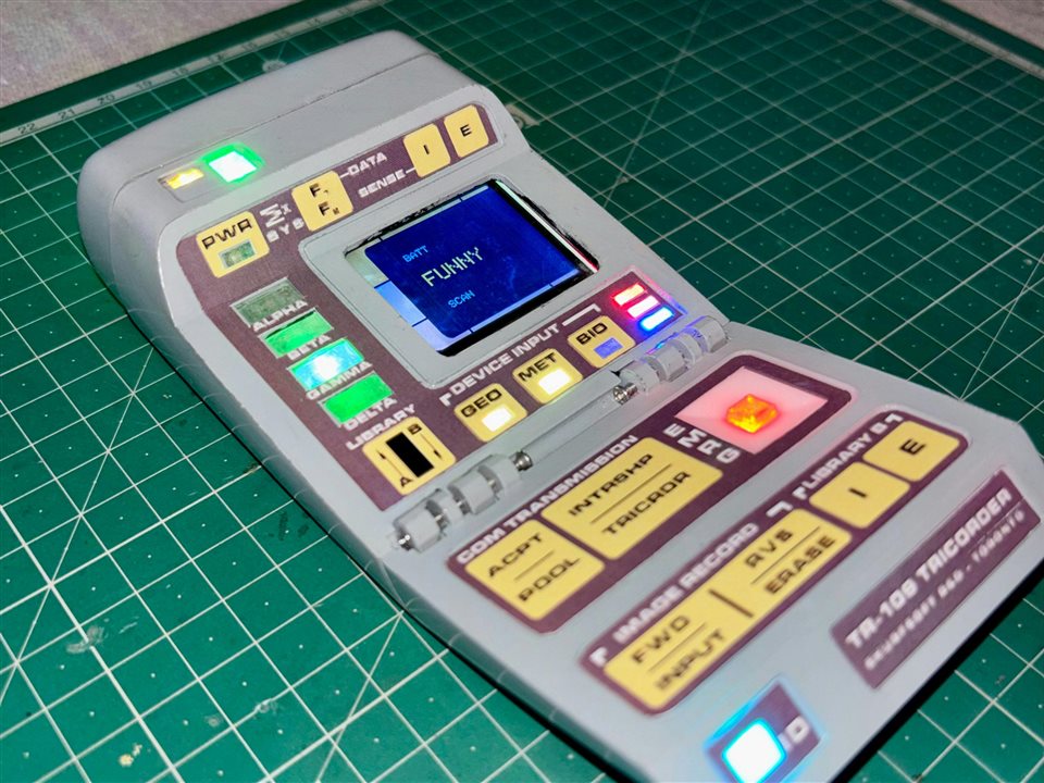

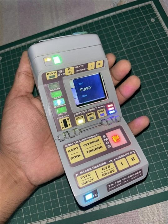

A couple of years ago I built a Star Trek Tricorder for a Hackster "TV Prop" contest. It looked the part but did nothing  just a shell. Afterward I actually watched Star Trek properly, realized what a Tricorder is supposed to do, and decided the prop deserved real functionality. That became Rev 2.
What it actually does now

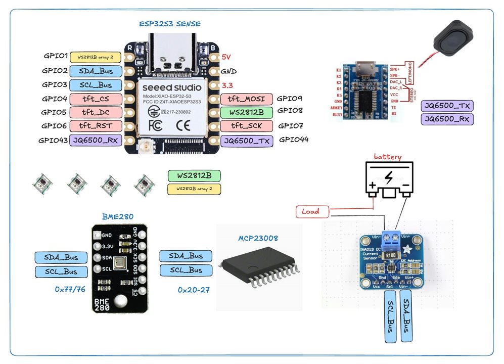

The whole thing runs on a Seeed Studio XIAO ESP32S3 Sense and packs in:
  • Environmental sensing — a Bosch BME280 reading live temperature, pressure, and altitude (calculated from the barometric formula)
  • Power monitoring — an INA219 tracking voltage, current, and draw in real time
  • LCARS-style UI — animations and menus rendered on a 1.8" ST7735 TFT

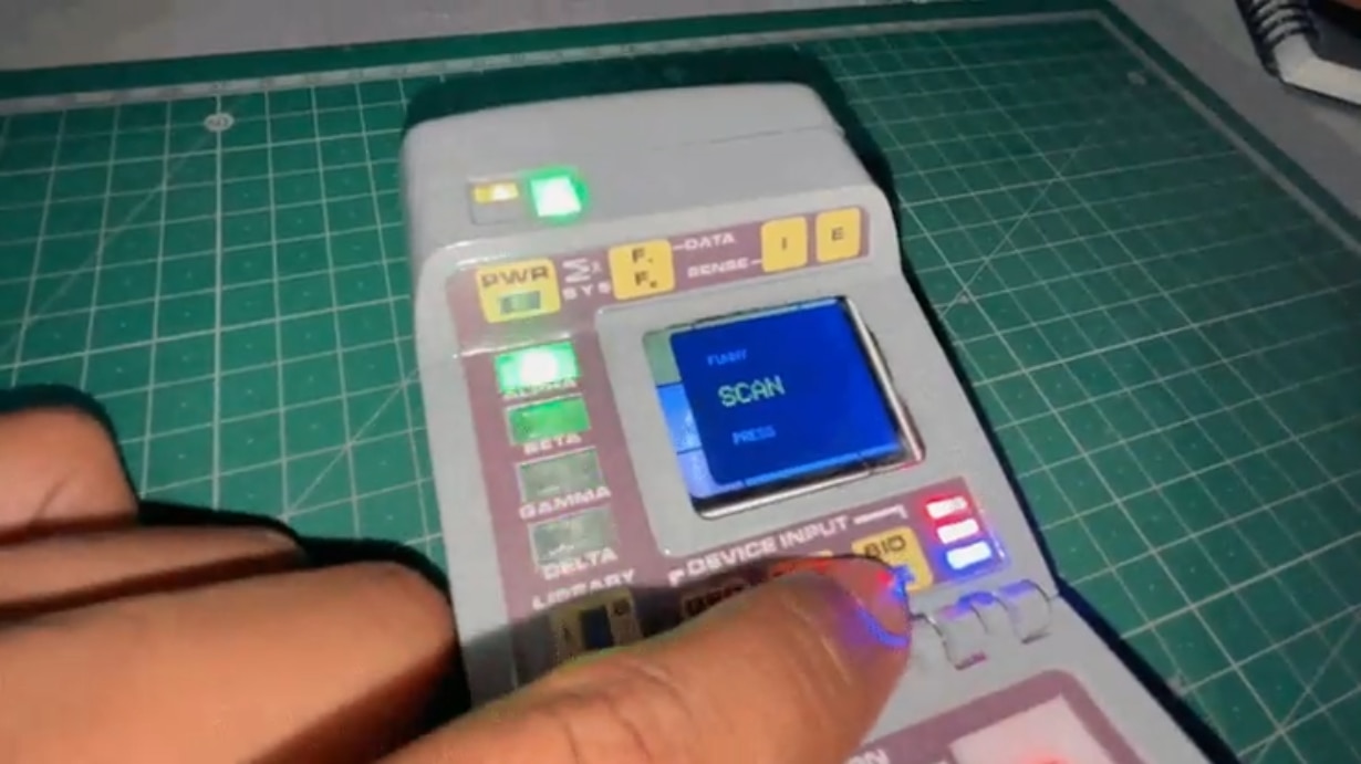

  • Touch-only navigation — six TTP223 capacitive pads (no physical buttons), read through an MCP23008 GPIO expander
  • LED effects — WS2812B arrays for the classic glowing indicator strips, toggleable to save battery
  • Sound — a JQ6500 audio module for startup sequences, scan effects, and alerts
  • Auto power on/off — a reed switch that triggers when the case opens/closes, just like the show
  • Rechargeable — Li-Ion cell with TP4056 charging
The build

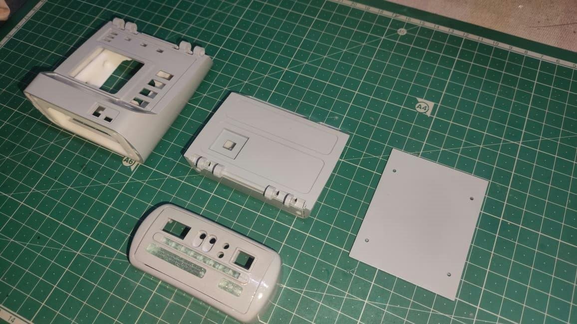

Electronics-wise it's two custom PCBs a main control board and a sensor panel linked by a 20-pin FFC cable, all designed in KiCad. The enclosure got a proper upgrade this time too: resin printing (courtesy of Justway) for a smooth main body, PETG for the LED diffuser sections so the light spreads evenly, then hand-painted and clear-coated.
Firmware is modular C/Arduino separate files for UI, sensors, LEDs, audio, and each "mode" (environment scan, alert, funny mode, startup animation), all coordinated from a single main loop.
