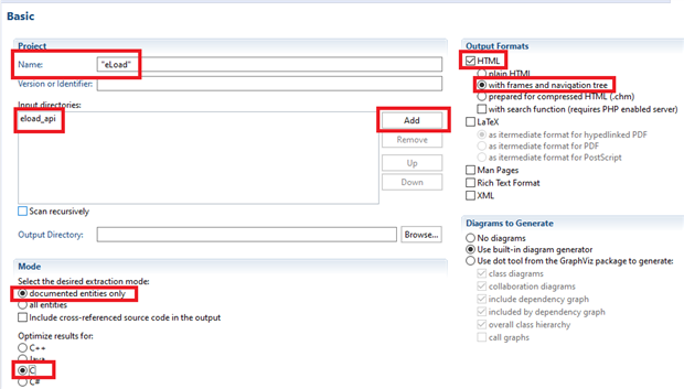

Add Doxygen to your Project
The first step is to add the Doxygen configuration. Select your project in the Eclipse Explorer.
Then click the small arrow next to the brand new Doxygen button and select Build Doxyfile.
This will automatically create a new configuration file for the project.
You can then double-click on that file to open the Doxygen editor.
I've used these settings to allow a slow and soft start, only documenting the project's main API..
Another option would be to generate maximum output by just checking Scan recursively and the All Entries mode.

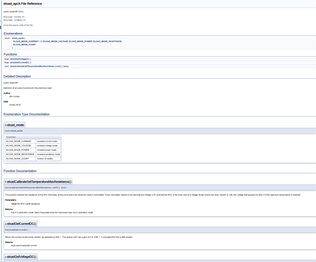

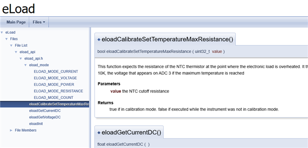

Generate the Report
When you press the @ button in Eclipse, the documentation is regenerated. You can then view the results in a browser.
This works fairly straightforward. And fulfills what I tried to achieve here.

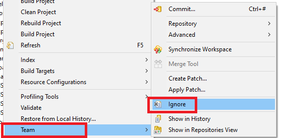

Version Control notes
I usually don't add generated files to version control. In this case the HTML docs and (if selected)  Latex files.
To avoid that a next commit will add these files, use your version control's ignore options to exclude the html and latex subdir of your Eclipse project.
If you use Git, the easiest way to do this is to run the Doxygen generator once, then right-click on these newly generated folders, then select  Team -> Ignore.
I have added the Doxygen configuration file to version control because I want this to become a part of the core. Like the make file.

    This is how my first attempt looks like:
