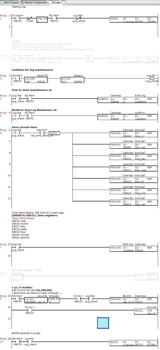

When I told our OEM  PLC supplier that we need to delete old log files, They just about lost it. We can write files, every second of everyday, but when the on board memory gets full,
there is no method to remove old datalogs. After a fun couple of weeks of being treated like some sort of terrorist, I have a few ideas. None of them are as solid as simply having the ability to delete a file.

The most novel one yet, Im calling
"Time Warp". In an effort to understand what systems do when there is a lot of data, Ive made scripts that generate dated log files, by manipulating the system clock on my PC, and repeatedly copying datafiles. This gave me the idea to do the same thing on the PLC.
I can not reliably delete a file yet, and when the SD Card is full, new logs are not kept.

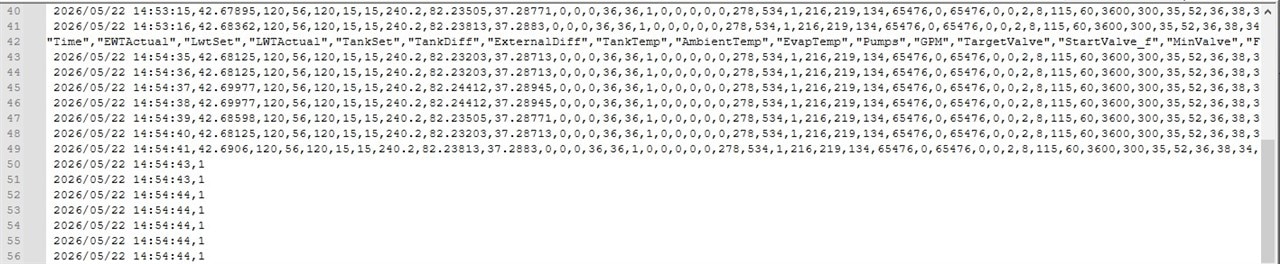

What I can do, is write less data to the same files, by manipulating the system clock.
Here is a concept test, where I have a PLC log file, with 69 data points per line. Then, I alter the system time, when the logs are full. This alters the output path of the data, for a datalog block, which then populates (over writes) with less data, for files named on the basis of the date when they were created.
Is it prone to lots of little problems I wish I didn't have to deal with?
Hell yeah it is! But it will work. Probably, for now.
Whats this even do?
well, when I detect that the SD Card is near full, I turn off the normal logging process.
Then, I save the current date and time.
on the basis of which code base is known to log at a given rate, I formulated the amount of data / time which the system must have operated, and define a set of start and end log maintenance times.
Next, I set the time to 2 years ago, and start pulsing the system time seconds register 1000 times a second. This steps through the log files with a 1 bit write, which is significantly less data than we normally log. I removed the time stamp after initial testing.
So then, I rapidly increment though time, overwriting files line by line, with 1 byte per line.
Where Im manipulating the system clock via the seconds register, the PLC manages the SD Card file IO / file names for me.
then where I reach the desired cut off time, I stop the log over write process, reset the system time, and resume normal logging.
CRAZY.
What happens in 10 years, when the SD Card is full of files with 86400 1s?
IDK, maybe I'll have convinced an PLC OEM that deleting a log file is a valid form of system maintenance by then.
