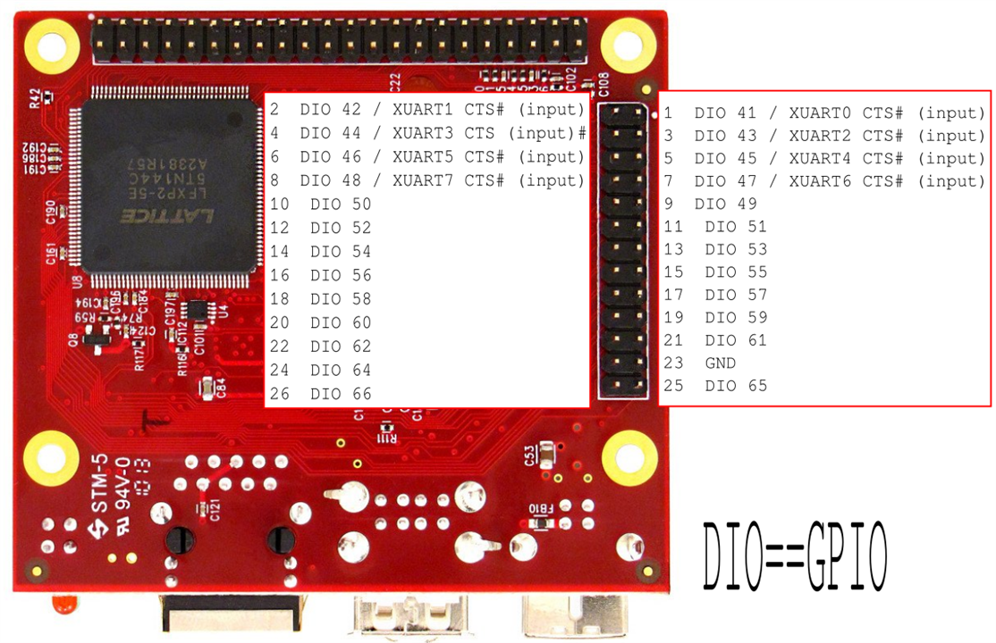

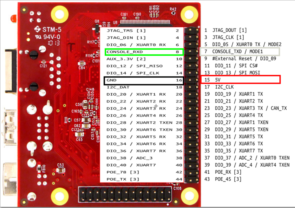

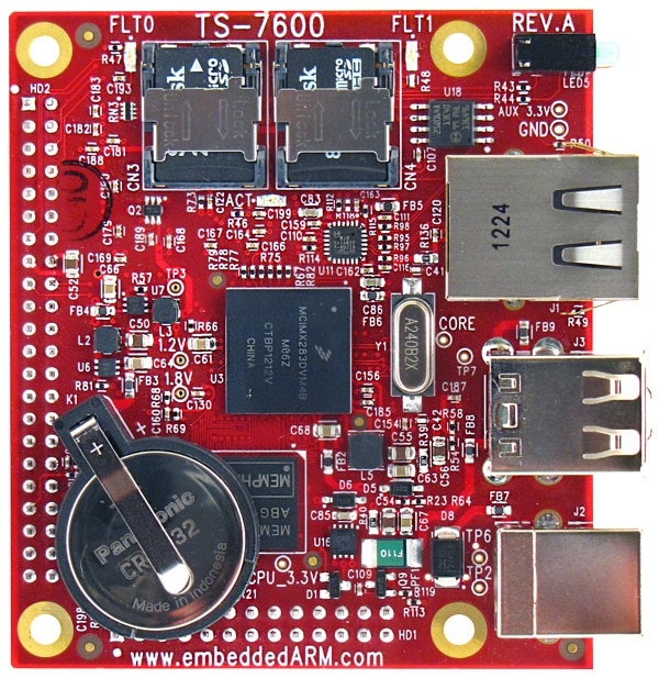

## The Hardware
[TS-7600 photo]
[UART wiring photo]
[GPIO / DIO connector photo]
My local makerspace has received a few hundred of these boards.
And strangely, this isn't even the first time we've received TS-7600s as a donation in the hundreds.
I'm honestly not sure where these things keep coming from. Apparently there are a *lot* of them sitting around somewhere.
Until now, the age of the software made it difficult to figure out what to do with them beyond using them for very specific embedded projects.
Modern Debian support changes that equation quite a bit.
These are still slow computers. There is no getting around 256 MB of RAM and a 450 MHz ARM CPU.
But now we have a modern kernel, a modern userspace, current Python, current GCC, and access to an enormous amount of software that was previously impractical or impossible to run.
Combined with the FPGA, analog I/O, 5 V GPIO, low power consumption, and the sheer quantity of boards we have available, that opens up some interesting possibilities.
