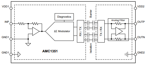

    dougw over 3 years ago
    Interesting project.
    Would an analog isolation amp work for this application? Like an AMC1351.
  • scottiebabe
    scottiebabe over 3 years ago in reply to dougw
    That is essentially what AJ designed from scratch
    Only transmitting ADC codes in parallel versus a serial bit stream.

    It is, but I can't see how that differential output works.
