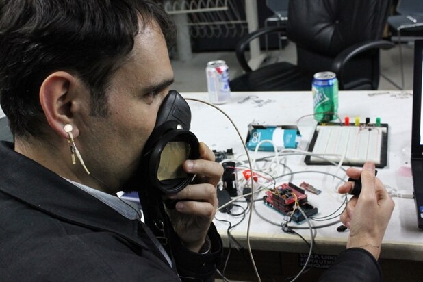

Dan, who designed the ECG shield, yet again played our intrepid test subject:
Photo by Jordan Bunker
