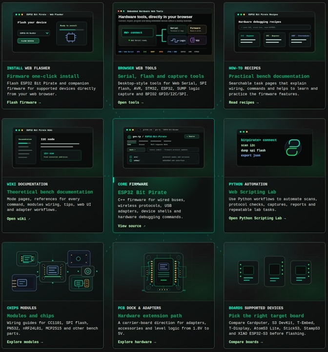

ESP32 Bit Pirate Web Site
A firmware for everyday hardware exploration
At its core, ESP32 Bit Pirate is an open-source firmware for compatible ESP32 boards. Once flashed, the board becomes a multi-protocol debugging tool that can be controlled from a serial terminal, a web-based CLI, scripts, or dedicated browser tools.
The firmware supports common bench workflows such as I2C scanning, SPI flash access, UART bridging, GPIO control, 1-Wire devices, CAN, JTAG/SWD, infrared, Sub-GHz radio, RFID, RF24, BLE, Wi-Fi, Ethernet, USB adapter modes and more.

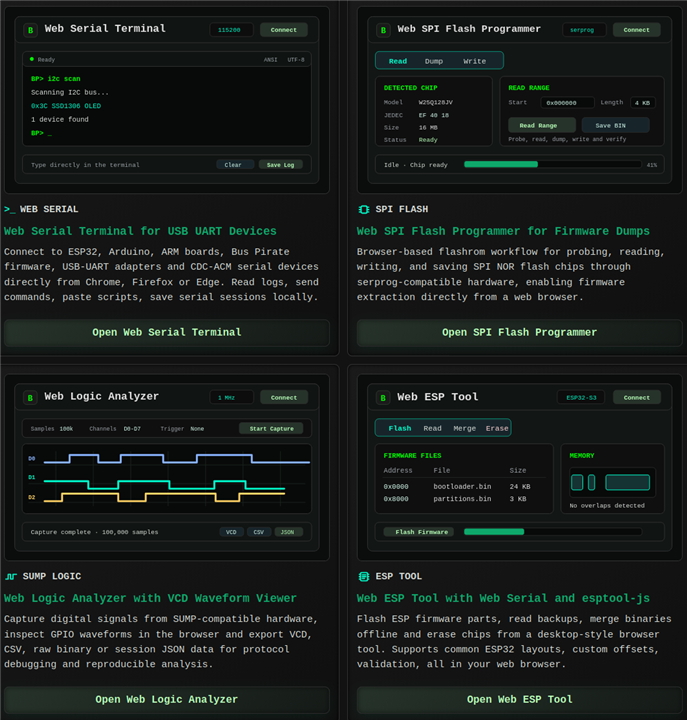

ESP32 Bit Pirate Web Tools
Why put hardware tools in the browser?
A lot of hardware debugging still starts with installing drivers, vendor tools, Python scripts, command-line utilities, or a complete development environment. That can be fine on your main machine, but it is not always ideal when you just want to quickly test something.
This is where the browser side of ESP32 Bit Pirate becomes interesting.
The project includes web tools that run as static pages and talk to local hardware through browser APIs such as Web Serial or WebUSB. That means many common tasks can be done directly from the browser: opening a serial terminal, flashing an ESP32, reading a SPI flash chip, capturing logic signals, programming an AVR, working with an STM32, or controlling GPIO/I2C/SPI through a bit-bang interface.

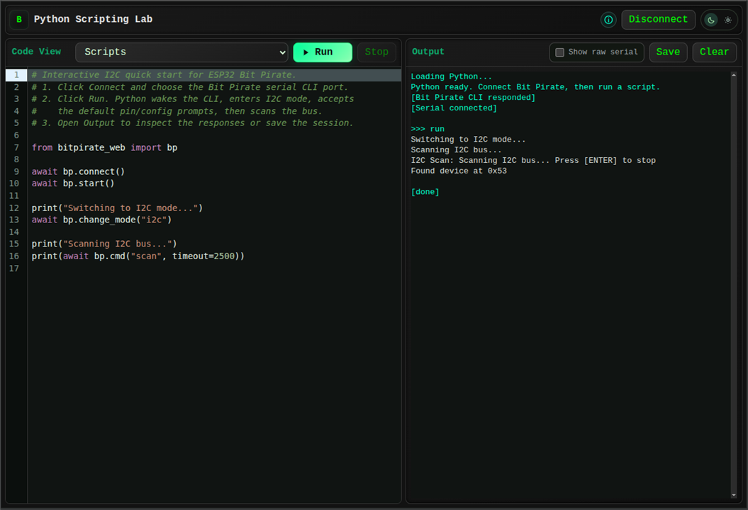

ESP32 Bit Pirate Scripting Lab
A site built around real workflows
The website was built to make the project easier to discover and easier to use.
There is a web flasher for getting started, a web terminal for talking to the firmware, protocol pages for understanding what each mode can do, module pages for common hardware, and recipes for practical tasks.
The recipes are especially important. Instead of only documenting commands one by one, they focus on real situations: scanning an unknown I2C device, dumping a SPI flash chip, sniffing UART traffic, wiring a CC1101 module, using a logic analyzer, or programming hardware from the browser.
