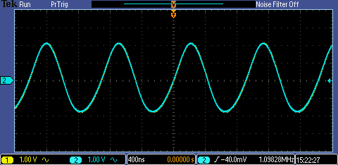

So, what else can I do? Here's the result of throwing a sine wave at it.
This is at a couple of hundred kilohertz. The loop can't respond quickly enough to totally counter the change, though it does manage to attenuate it considerably.

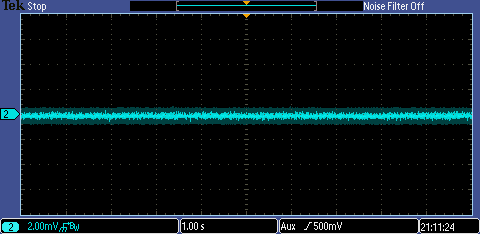

This first is the 'scope noise with an old 50 Ohm terminator attached to the input connector. That's probably mostly the oscilloscope's vertical amplifier noise. The thermal noise from 50 ohms over 20MHz [566nV rms] is next to nothing in this context, and even with a few tens of uV of excess lf noise, depending on the composition of the resistor in the terminator [have I understood that right?], I don't think it's going to change what I see there much.
That's looking to be something like 2mV pk/pk, or 330uV rms if we assume a crest factor of 3.

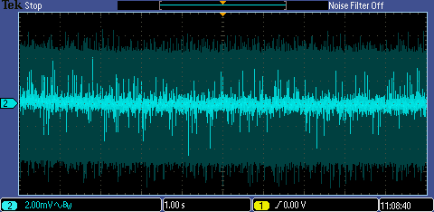

Here's the regulator with power on, but no output capacitors.
A noticeable increase in the noise.

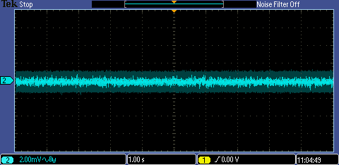

This is with a 10uF electrolytic on the output
which has improved things quite a bit.

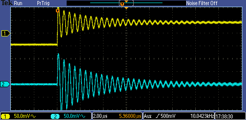

With a light load of 2k2 [2.3mA] it is stable, but only by the barest of margins: it does this with a square wave kicking the output.
'Ding, dong, the bells are going to chime.'
(We can see the ringing on the generator's square wave, too, because the generator has an internal 50 ohms in series with the output, for series-terminating the coax, so with my externally added 50R resistor there's actually a potential divider in play.)

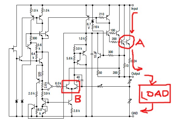

Why the difference in stability between the positive and negative regulator?
That becomes evident if we look at the equivalent internal circuits provided by ON Semiconductor in their datasheets for their 7805 and 7905 parts.
Here's the 7805. It's fairly straightforward. I've marked the pass element (A), and the differential pair (B) that compares the potted-down output voltage with the internal reference voltage, to help you orientate yourself if you're not used to discrete circuits.
The pass element is a pair of NPN transistors acting as emitter followers.
