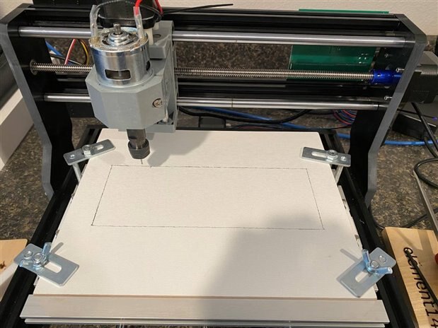

I decided to try a smaller inexpensive HEPA filter with a carbon pre-filter.  I just needed to adapt it the blower intake by adding a baffle.  Here's a picture of the intake hole and the filter components and the art panel box that I used to create the baffle.
I cut the hole in the panel box using my CNC unit (I had to swap the laser out for the spindle).
