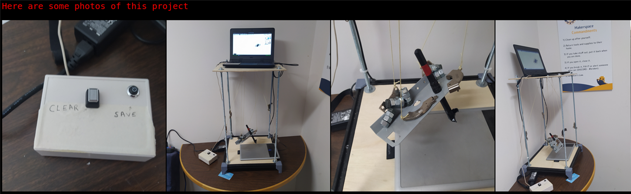

I built a 18 inch square platform using 3D printer parts, and 4, 26  segments of threaded rod. I mounted an electrical box cover plate on the top of the plywood covering the platform, and used magnets an string to create a pulley system to adjust the pendulum body.  Placing the magnets in different positions, resulting in different lengths,  and angles, produces different chaotic motions. I made an acrylic pen holder, but that was ultimately replaced with a piece of metal I found in a dumpster. This meant I could use 3 magnets on each pendulum, and adjust their height, and placements in 3 positions each.  I also added some bolts loaded up with nuts to allow mass to be added in various ways, to effect efficiency and run time of the harmonograph.
I placed the Drawing tablet below the pendulum, and a computer running myPaint, on the upper platform.
Then I created a little remote console with a clear, and save button. I used a teensy 3.1, with a RTC module to generate time stamps. The computer was a file server, with NGINX running, so I wrote a line into the myPaint config file telling it to save to  the appropriate location.
The Arduino Code would send key strokes to clear the screen, or save the current file with a timestamped file name.
This project went through several iterations, and was on display at the Bangor Makerspace from September 2022 to February 2024.

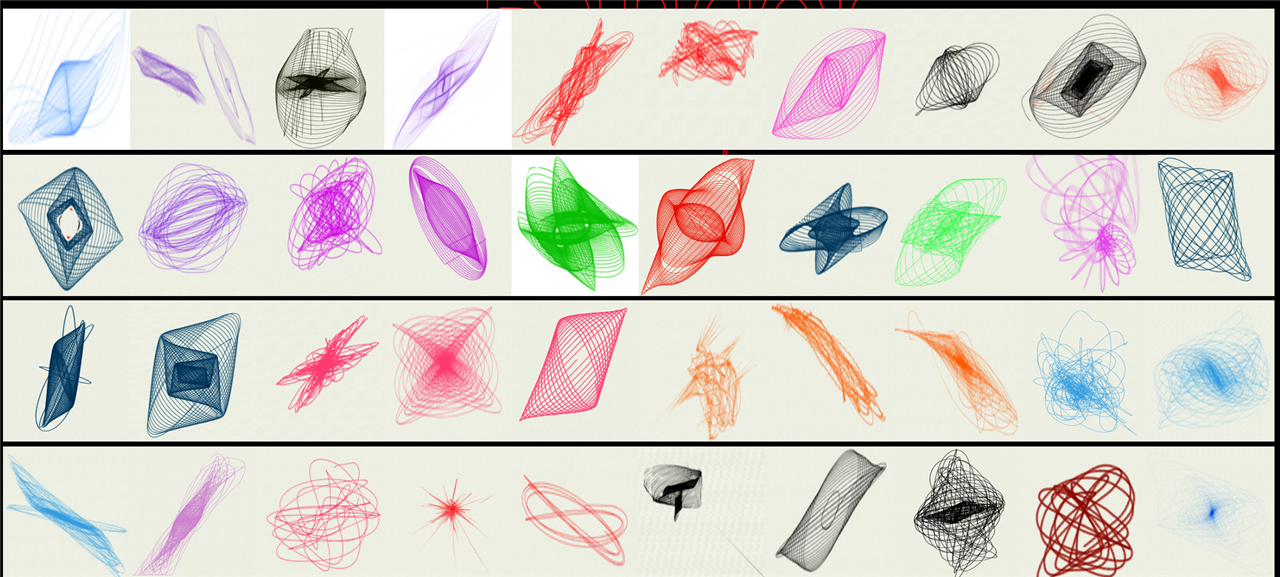

Here are some of the pictures drawn by various visitors:
Harmonographic output.

And here is some unflattering photos of the harmonograph:
Harmonograph
