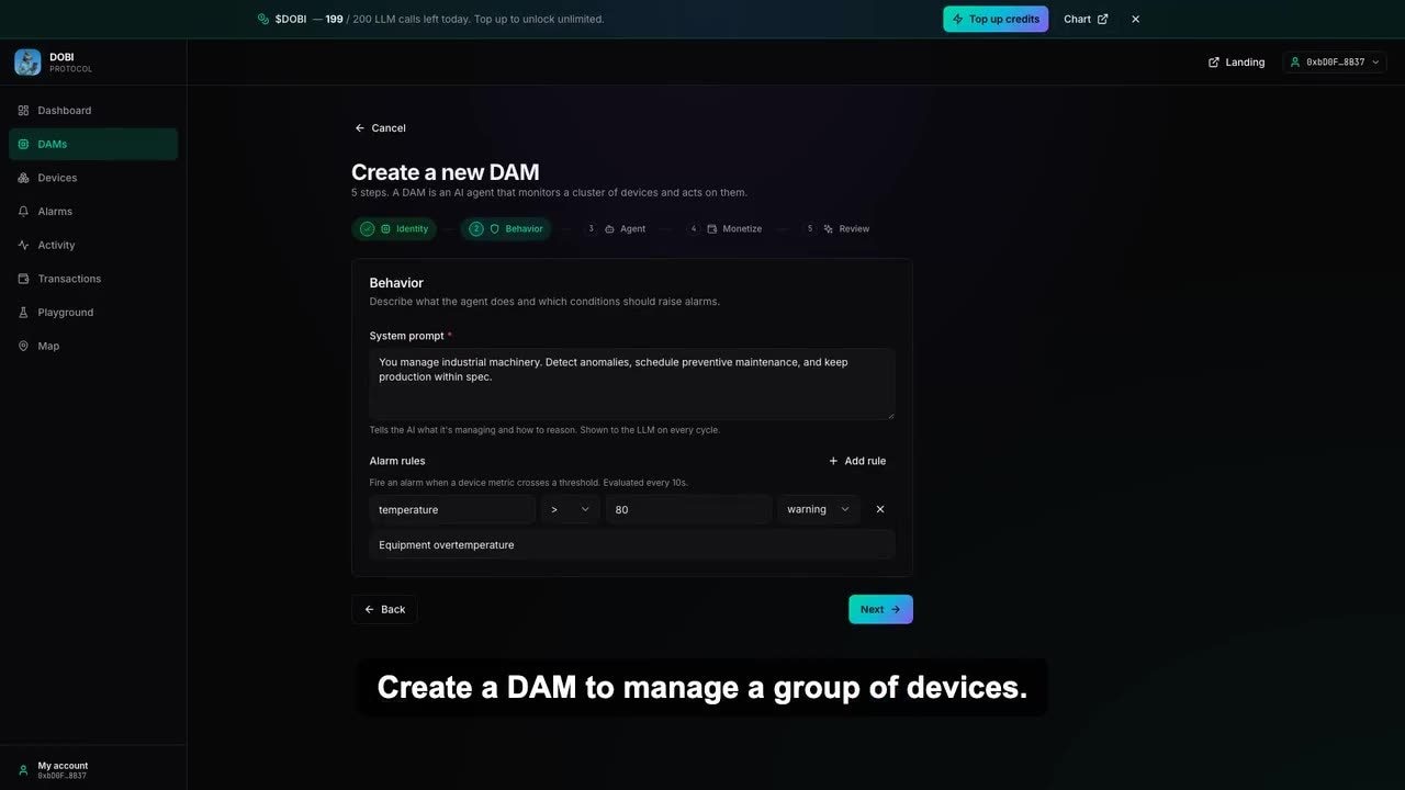

    Step 3: Behavior: system prompt and alarm rules
    Behavior is where the agent gets its job description. The system prompt tells the AI what it is managing and how to reason; it is shown to the LLM on every cycle, so be explicit about the metrics you care about and the actions you permit.
    Alarm rules fire when a device metric crosses a threshold. They are evaluated every 10 seconds, with no LLM required, so they keep working even when the model is slow or unavailable. Define them as data with the metric name, the comparison, and the threshold, matching the shape below.
    Example alarm rules · json
      { "metric": "temperature", "operator": ">", "value": 60, "severity": "warning", "message": "High charger temperature" },
      { "metric": "power_kw", "operator": ">", "value": 130, "severity": "critical", "message": "Power overload" }
    The usual failure is writing a threshold that never matches a real reading, for example a unit mismatch or a metric name that the device does not publish. Watch the activity log after creation: no alarms with devices clearly out of range means the rule never matches.
