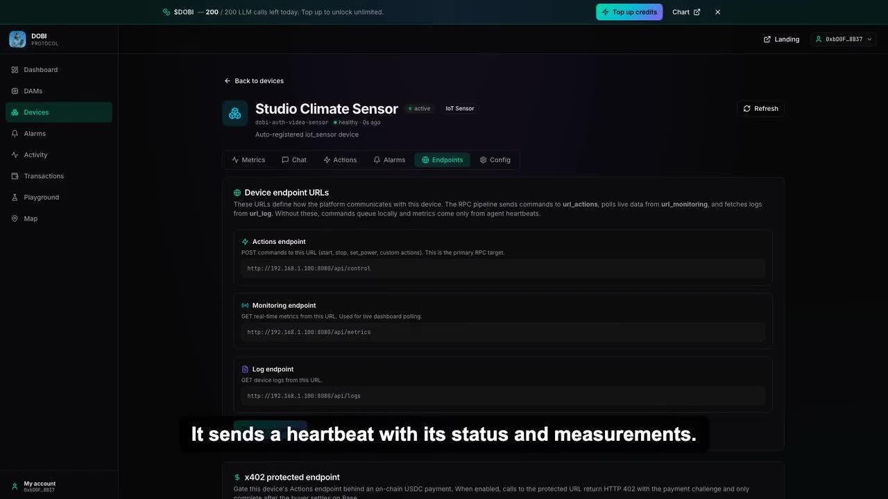

Seconds after the first heartbeat the device shows up as healthy.

Upload it to the ESP32, open the Serial Monitor, and watch for the registration confirmation and the first heartbeat. Then open the Devices tab in the DOBI dashboard: your device should appear online with its status and latest metrics.
