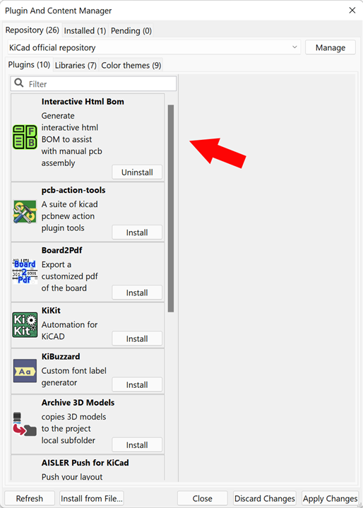

My friend Adrian recently showed me a plugin for KiCad that makes determining placement of components while populating a PCB easier.  KiCad 6 has a feature that makes adding plugins simple.  Open up KiCad and select the Plugin and Content Manager from the main window.
Select Plugin and Content Manager
Once inside, install "Interactive Html Bom" and apply the change.
