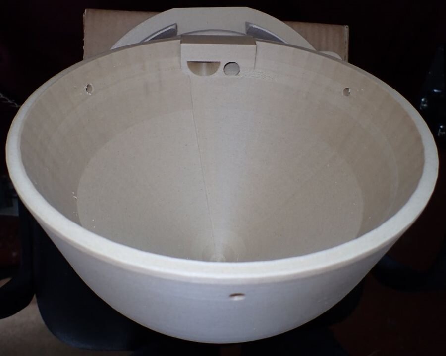

    "...Looking forward to seeing pics of your beebox..."
    Front view
    Entrance detail
    Top down view
    Top down view of base
    Underside of base
    Underside of top dome cover
    Info sheet / Wildflower seed paper

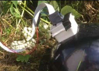

  • ralphjy
    ralphjy over 1 year ago in reply to beacon_dave
    Thanks for the pics.  I was a bit disappointed that they didn't leave the mounting structure for the infrared camera.  I'm interested to see they set that up.
    I haven't read the paper completely but did they explain the reason for that particular entrance design?
  • ralphjy

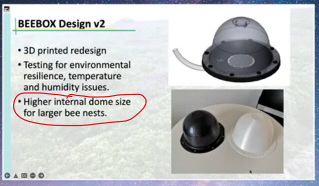

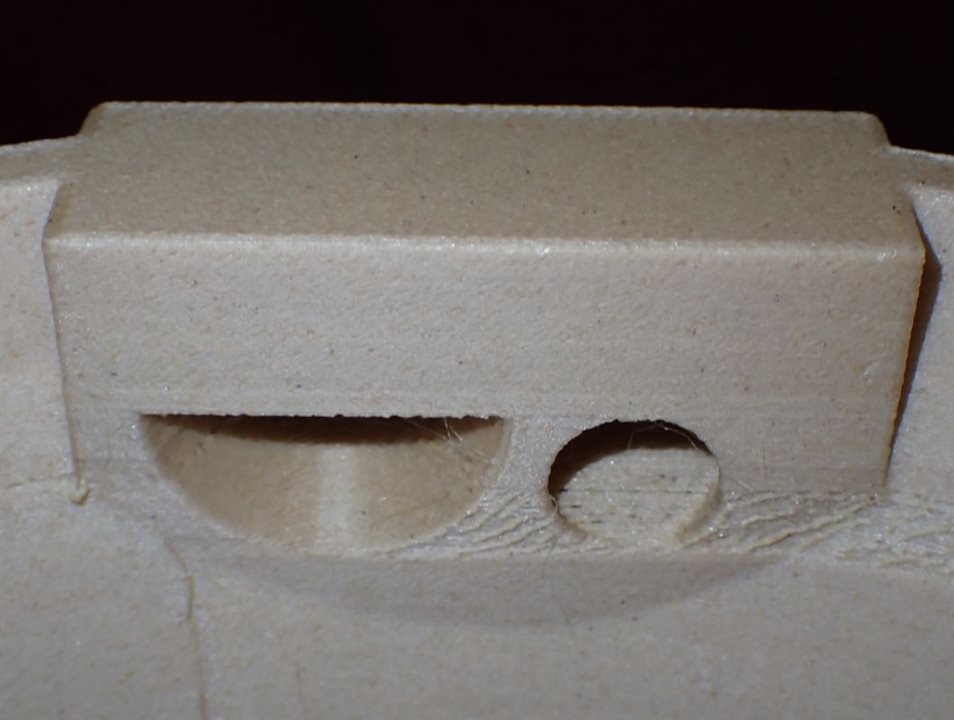

  • beacon_dave
    beacon_dave over 1 year ago in reply to ralphjy
    I guess that they didn't think that the majority of the sales to the public would use it. Apparently as of this morning, they have had 27 people interested in buying one.
    If you look closely at the inside of the dome there is now a 'false ceiling', presumably for insulation purposes. It's conical on the inside, dome on the outside.
    I recall that they mentioned redesigning the entrance as the bees were plugging up the original design with grass.
    V2 & V3
    "...and some parts of the design didn’t quite fit the bees’ needs, such as entrance holes that bees had to block with grass..."
    V4
    "...The new design had better insulation, more effective temperature regulation, and improved entrance features..."
    I noticed with the bees nesting in my air brick, the bees exited from a different hole than the one the entered from (avoids a collision at peak times perhaps) so I'm guessing the larger shaped hole allows room for deploying wings during take off. It's the same arrangement on the inside, round hole transitioning to a D shape hole.
  • ralphjy
    Ok, that makes sense.  I didn't pick up that the holes were the same shape but reversed direction.

  • beacon_dave
    "...I was a bit disappointed that they didn't leave the mounting structure for the infrared camera.  I'm interested to see they set that up..."
    https://www.lancaster.ac.uk/news/bee-box-provides-stress-free-insight-into-hidden-life-inside-the-hive
    24 hours inside a bumblebee nest
    https://www.youtube.com/watch?v=SBxY-08qp1g
