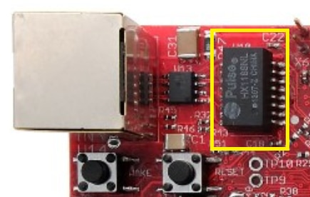

On many Ethernet devices, you find magnetics - a transformer - as part of the physical layer.
The example above is from a TI TM4C launchpad. It looks like a solid block - like a silicon package.
I have a defect launchpad so I scavenged some parts.
To my surprise, this is how the transformer looks like from the underside:
Surprisingly old school.

    Gough Lui wrote: I'm surprised this one wasn't covered in potting compound / resin, as most of them seem to be. - Gough The coils seem to be glued in. They are fixed on the spot. But no potting.

    I'm curious after reading your post. That must be what is under the Ethernet canister hood of the Pi. I don't have a failed Pi to put under the knife to have a look, so I will just imagine. The theory…

    In the case of the Pi, it is integrated into the RJ45-style jack housing - hence why those are known as "MagJacks". Curiously enough, the Ethernet on the first batches of Pi was non-functional purely because…

    I know that's what's inside but it just doesn't seem that something so simple would be capable of handling data at gigabit Ethernet speeds.
    Jan Cumps over 5 years ago in reply to Fred27 +1
    This one This one is spec'd for 100 Base
