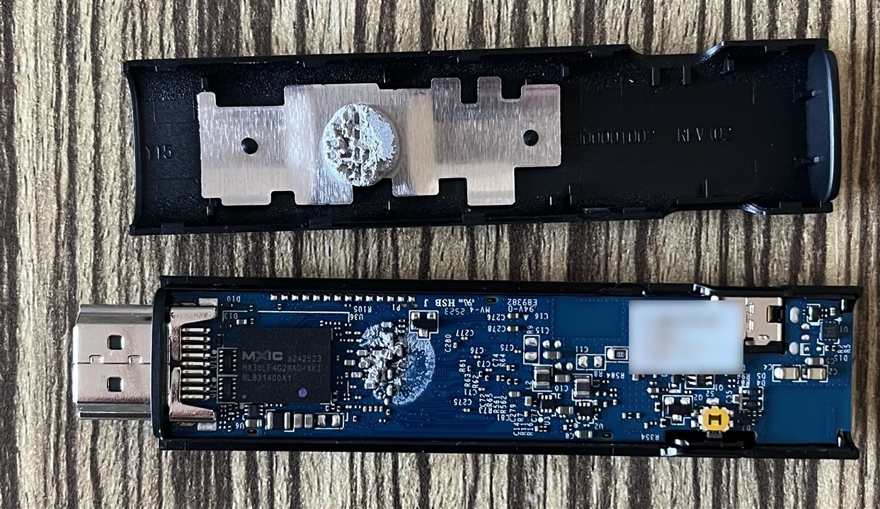

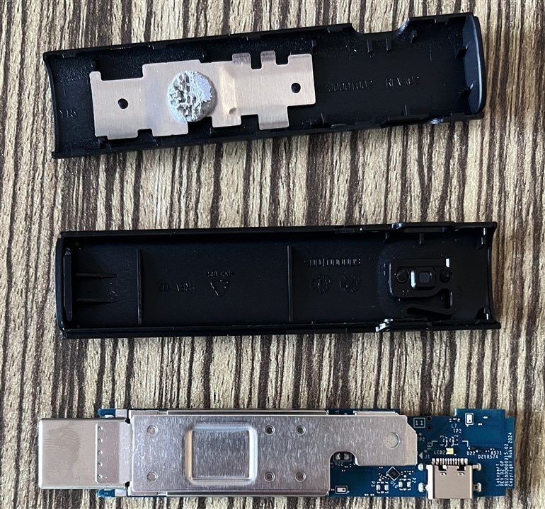

Today I have decided to take a look into the internals of the Roku Streaming Stick, the version model 3840X released in 2025. I checked the sides of the housing and, after a while with the usage of the triangular openers, the plastic cover was opened. Below is a photo:

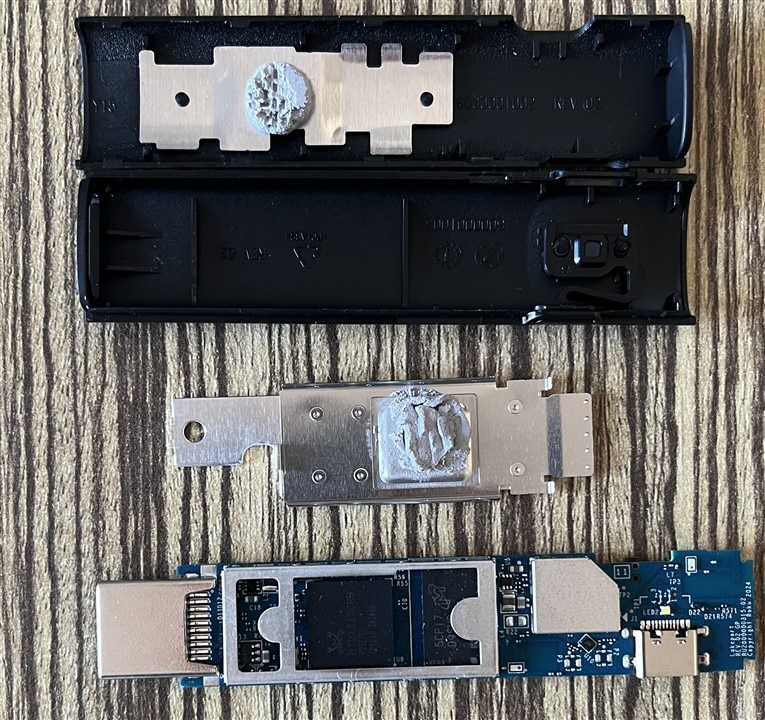

We see that the bottom part has a built-in small metal plate that is connected to the PCB via thermal paste and acts as an additional heatsink. Near the HDMI socket there is an IC which is storage: Macronix MX30LF4G28AD-XKI. It is a SLC NAND flash with 4 Gb (512 MB x 8 bits) and uses a parallel interface for communication. Below is a photo after removing the top plastic cover:
We can see a USB-C connector used to power the device, along with an aluminum plate that acts as the top lid of the shielding cans. Fortunately, it wasn't glued down and could be fully removed. Here is a photo with the top lid removed:
Also, in this case, the aluminum lid was connected via thermal paste with SoC and acts as heatsink. The SoC in this case is Realtek RTD1212CRB. I have not found much information about it, but it seems to be 4 x ARM Cortex-A55 SoC (probably similar to RTD1311). Near the SoC is located RAM marked with D9SHB. It is Micron MT41K512M8DA-093:P which is 4Gb (512 MB) 1066MHz 2133MTPS DDR3 DRAM. The last can near the USB was fully soldered and might contain the WiFi/BT chipset. I briefly inspected the test pins with a logic analyzer, but I did not find appearance of an accessible UART. Apart from that, I performed a small test in which I set a Wi-Fi point for which I captured all packets and used that point to connect that device. The device was in FTI and additionally asked for new firmware. For a quick test, I checked whether there was any HTTP traffic and found these two requests:

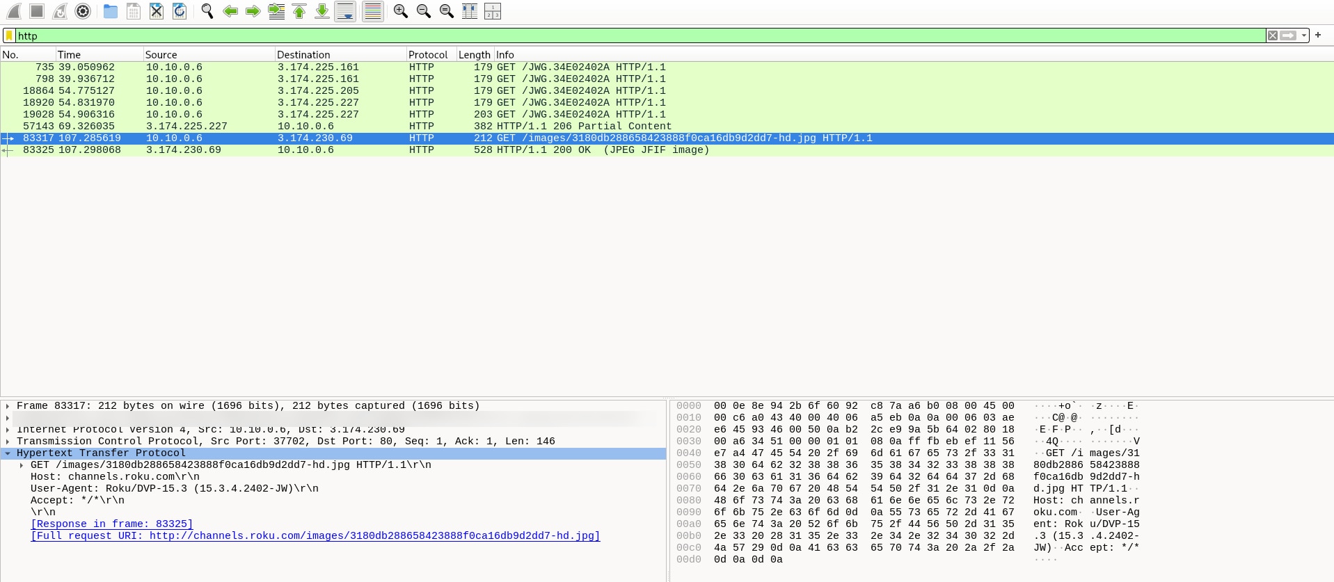

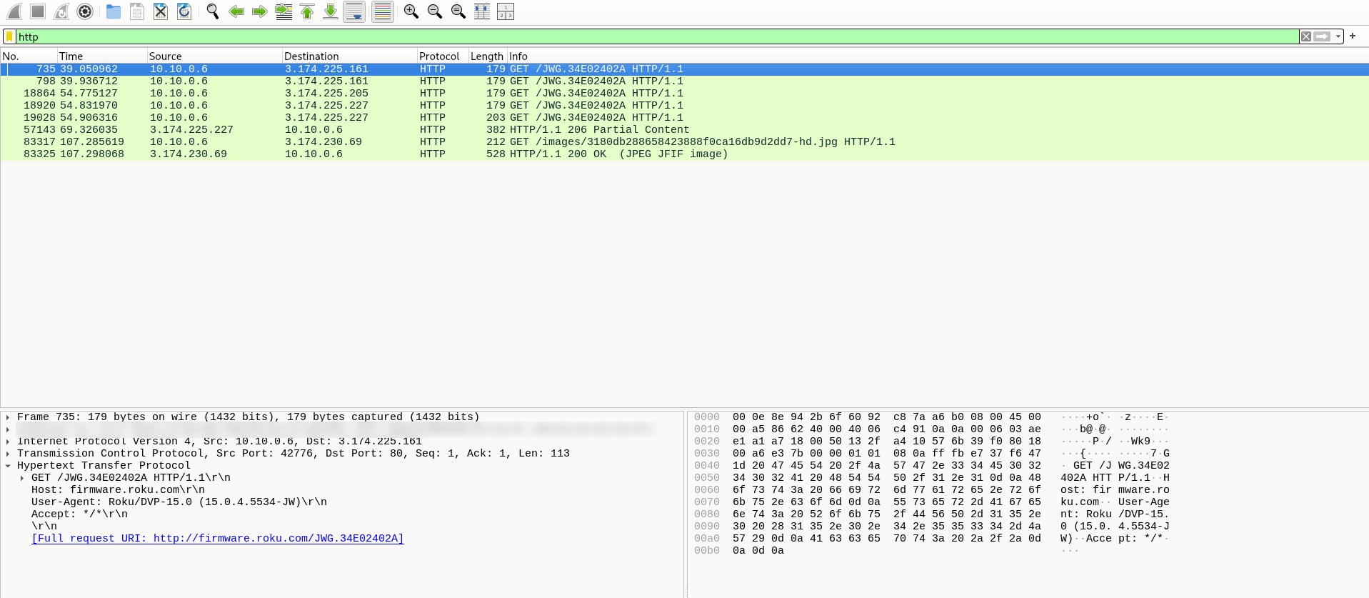

The first one was a JPEG image for some purpose. This could probably be a good entry point for exploring whether the device properly parses a suspicious JPEG delivered via a man-in-the-middle attack. The second request was for the firmware upgrade package from the upgrade server. I downloaded the file to take a closer look at its contents. The initial inspection was performed using Binwalk, a tool commonly used to analyze binary files and identify embedded files, compressed data, and other recognizable file formats.
