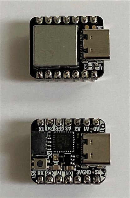

And recently I found that Adafruit had made the QT Py, a variant of the Xiao, that adds some other features but has the same footprint and pinout https://www.adafruit.com/product/4600
Adafruit QT Py
Same size, form-factor, and pin-out as Seeed Xiao
Primary differences
ATSAMD21E18 processor which has a smaller package with only 32 pins so only 4 Sercom  26 IO  10 ADC
Built in RGB NeoPixel LED
PWM Pins 9
Analog I/O Pins 9
I2C port with STEMMA QT plug-n-play connector
Optional SOIC-8 SPI Flash chip on bottom
Reset button for starting your project code over or entering bootloader mode
Price $6.00

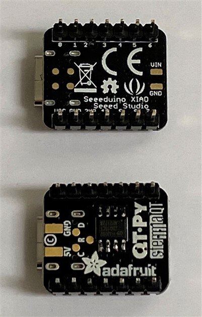

So, you can see that Adafruit traded off some I/O pins to get space for extra features.  I like the added reset button because the SAMD21 is easy to lock up and with the Xiao you need to short the reset pads to get into bootloader mode.
The NeoPixel is nice but the feature I really like is the ability to add additional flash memory to the bottom of the PCB.  Adafruit has a 2MB Flash chip for $1.25 http://www.adafruit.com/product/4763. I think that they added that capability to be able to run larger CircuitPython programs.
Here's a picture of the two boards, the Xiao is on top and the QT Py on the bottom.  You can see that I've added the flash chip on the QT Py.  The Xiao has 4 single LEDs adjacent to the USB-C connector - 1 user, 1 power, 2 for Tx and Rx of the UART.
