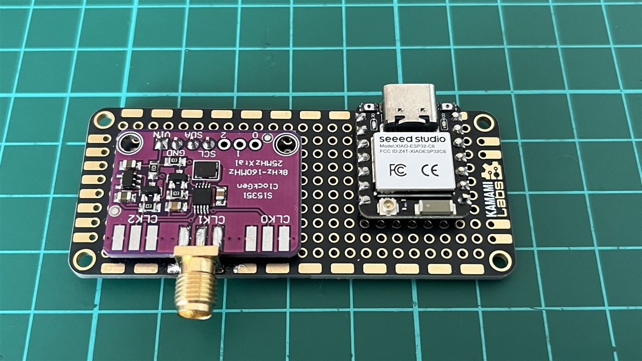

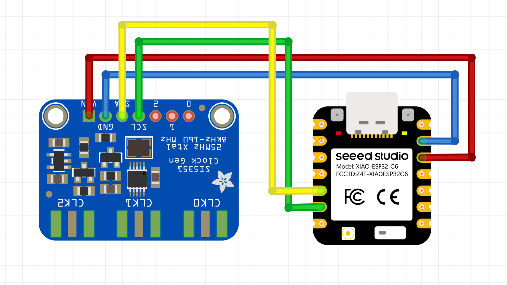

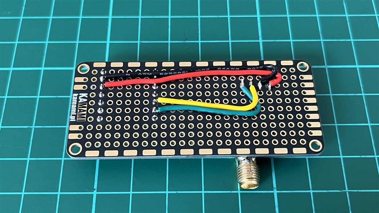

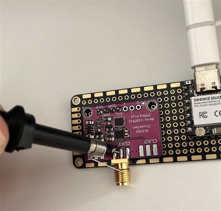

The main concept was to build a clock generator that supported at least a 50 MHz frequency. I have decided to use a module with Si5351. This module supports the three simultaneous outputs for which it is possible to set individual output frequencies. I have decided to use only one output for now. This module is controlled via I2C. As a control module, I have used a XIAO board with ESP32-C6. As a control interface, I have decided to use software Wi-Fi AP and a simple webpage which allows control parameters like: frequency and turning on/off the clock output. Below there is a diagram of the connections between these two modules:
The connections were made on double-sided universal board with dimensions 30x70mm. Below is the result of soldering:
The code uses the etherkit si5351 library to drive a clock generator board, and software Wi-Fi Access Point for serving webpage, and handling actions like setting frequency and toggling output. Below there is the source code:

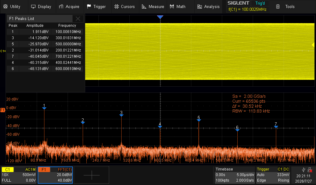

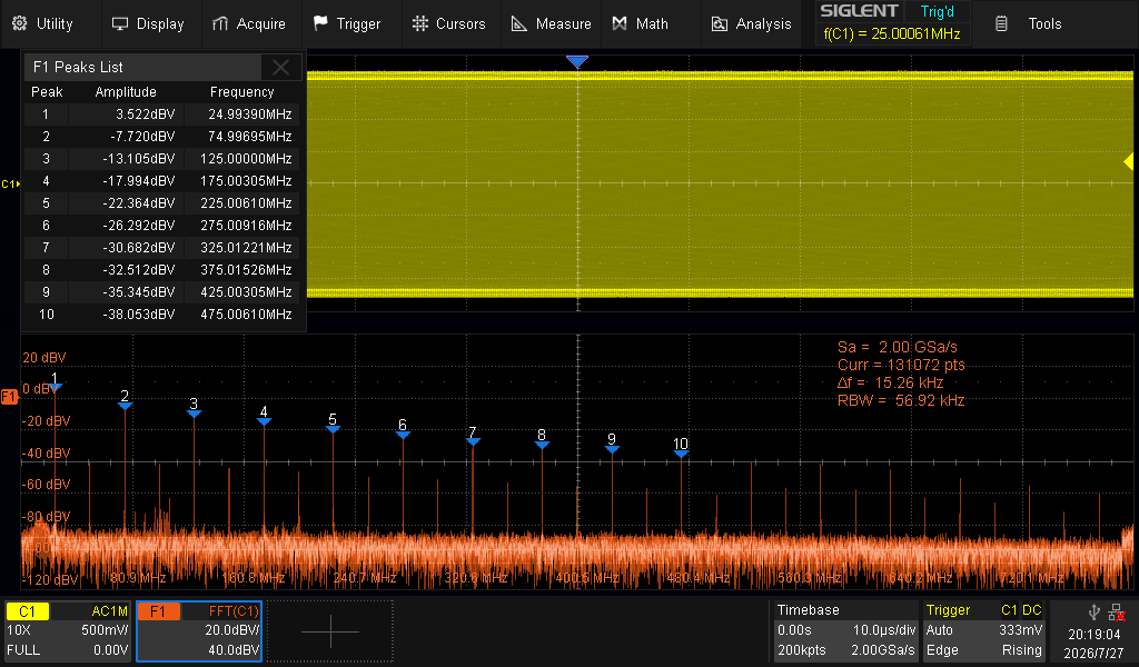

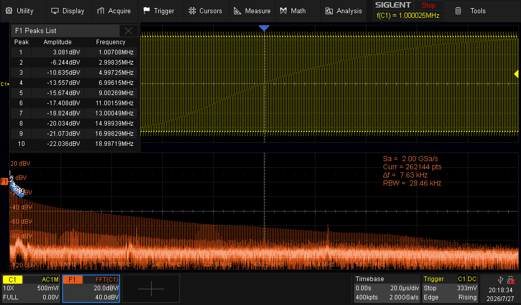

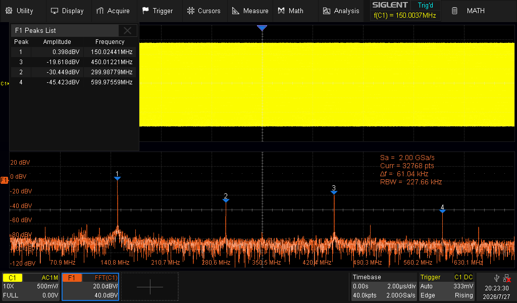

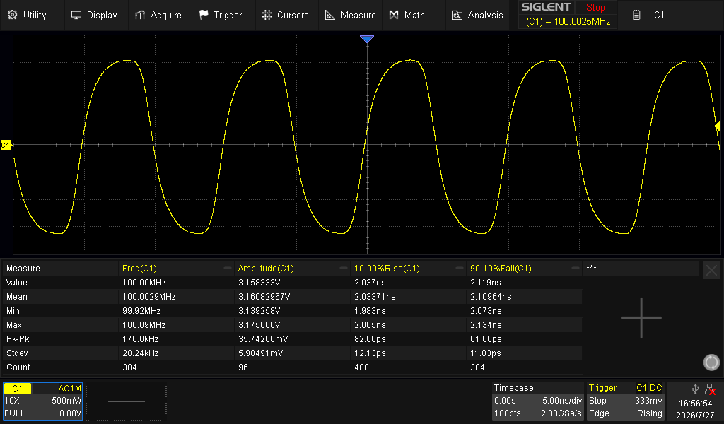

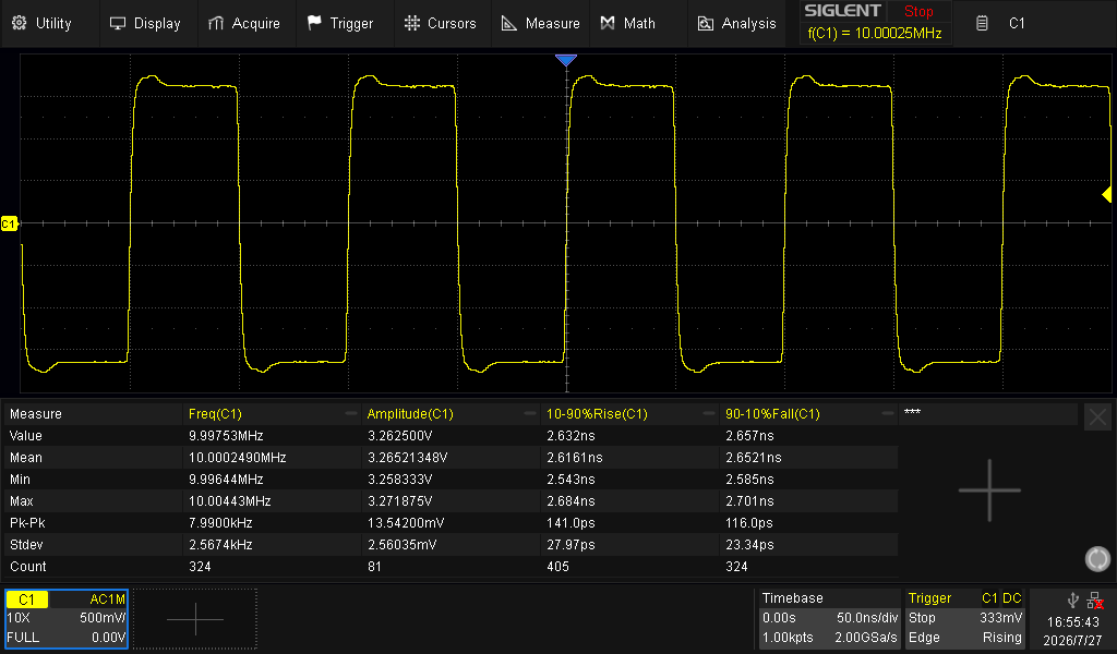

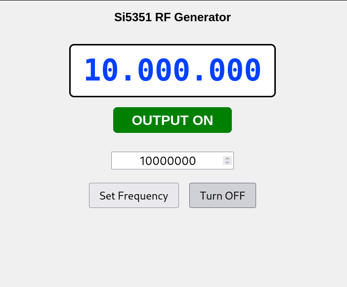

The code was compiled and programmed to the ESP32C6 with usage of the Arduino. After initial testing, I found that it was required to set a higher output current by setting: SI5351_DRIVE_8MA, to get better results on higher frequencies.The webpage with control panel is available at address: http://192.168.4.1 after connecting to the SiClockGen Wi-Fi access point: Below there is what the page looks like:

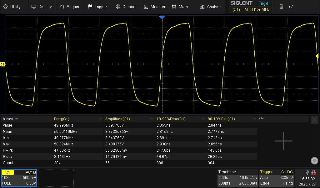

The testing was done using direct probing via a passive probe as on the following picture:
Below there are results of measurements for clock frequencies of 1 MHz, 10 MHz, 25 MHz, 50 MHz, 100 MHz and 150 MHz:
{gallery}Output clock measurement
1 MHz clock
10 MHz clock
25 MHz clock
50 MHz clock
100 MHz clock
150 MHz clock

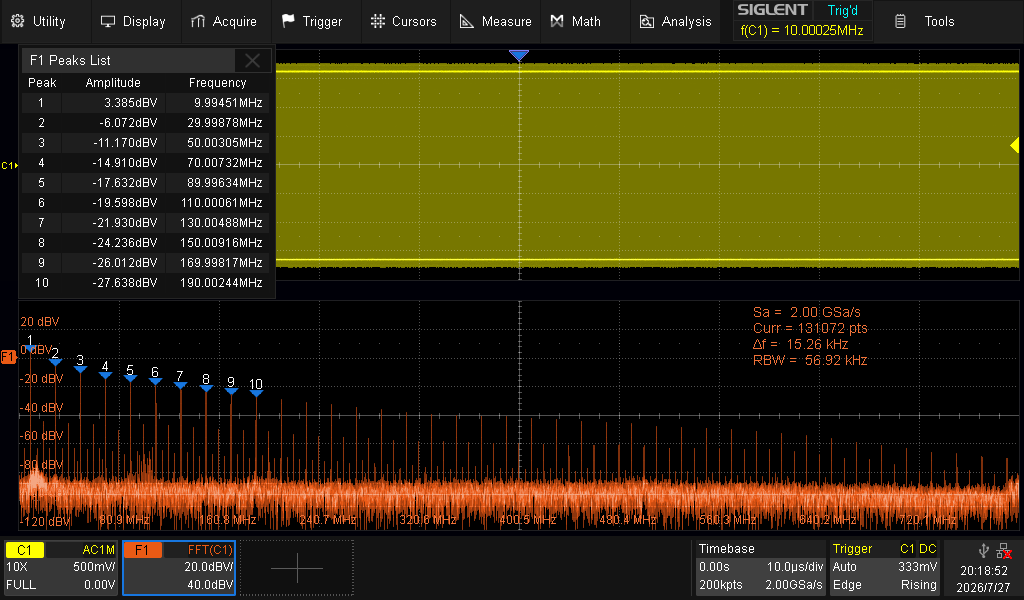

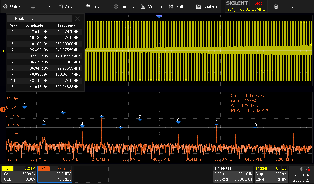

Below there are measurements with FFT included:
{gallery}Output clock measurement with FFT
1 MHz clock
10 MHz clock
25 MHz clock
50 MHz clock
100 MHz clock
150 MHz clock
These measurements were done with a SP5050A passive probe and SDS2000X HD. It will be worth checking with usage a 50 Ohm input and direct connection via coaxial cable. I am waiting for the adapter from SMA to BNC to check it.

  • kk99
    kk99 3 months ago in reply to wolfgangfriedrich
    I have also added measurements with FFT enabled.
  • wolfgangfriedrich
    wolfgangfriedrich 3 months ago
    Would be interesting to see the FFT graphs of the different clock speeds and calculate the scope roll off at 200 MHz and above.
