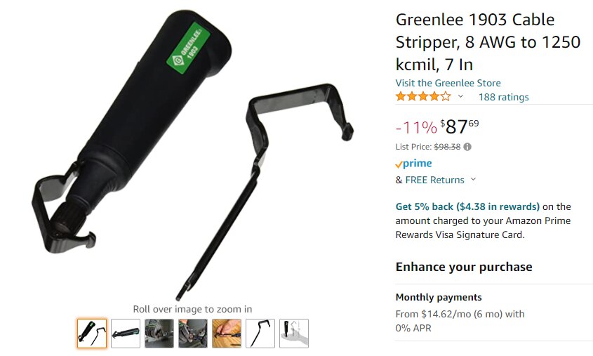

    Jan Cumps over 4 years ago in reply to aspork42
    this description might be confusing... sorry!
    Yes it was confusing - but correct :). There's a video that shows what you write:
    shabaz over 4 years ago in reply to aspork42
    Nice! There is a compact version that is less flexible (it cannot slit lengthways), I use it for coax, Main disadvantage of the one below however is that it is screw-set, and it takes so long fine-tuning the blade setting (tens of minutes!) that it's really only for set-and-forget for one cable thickness : ( so the one below rarely gets used. There's also a Knipex ErgoStrip which is like a lower-cost version of the Greenlee one, but the Greenlee one looks to be of noticeably better quality.
    dougw over 4 years ago in reply to aspork42
    Cool, I've used coax strippers, but never seen multiconductor strippers.
  • aspork42
    aspork42 over 4 years ago
    If you've never used cable strippers, you don't know how much you're missing!
    We use these at work to pull the jackets off of multi-conductor cable. They are super easy to use - slip the cable into the notch, then rotate the tool around the cable. The little tiny blade cuts the jacket neatly. You can then turn the handle 90 degrees and slit the jacket lengthwise as you pull the cable out. I know that this description might be confusing... sorry! It takes only seconds to strip a multi-conductor cable. This Greenlee is pricy, but there are less expensive options out there. If you strip a lot of cable, this is something to consider.
