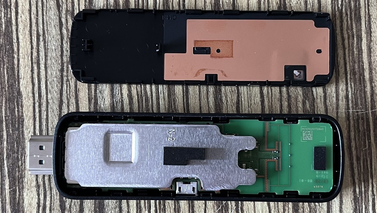

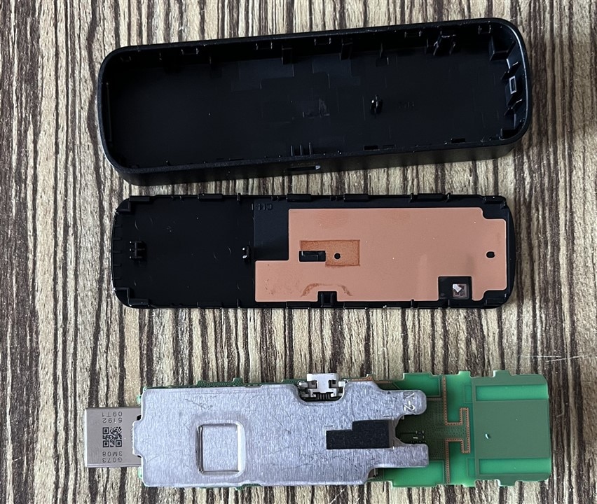

The Amazon Fire TV Stick 4K Select is quite a new device equipped with MT8698 SoC, that runs four ARM Cortex-A55 core, 1 GB LPDDR RAM and 8 GB eMMC. This device is the one of first that runs a new operating system called Vega OS, that is based on Linux, not Android. I have decided to check how this device looks inside. The device has the form of a small stick. With the usage of the triangular openers, it was really easy and quick to disassemble the housing. Below is a photo of the opened case:

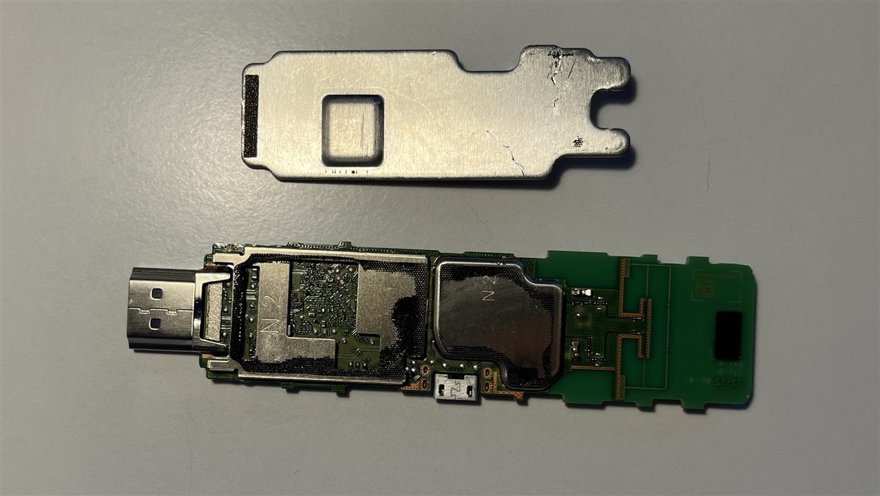

On both sides there are soldered shield cans, with glued by double tape aluminum plates, which act as additional heat sinks. Here is a photo with the top of the top aluminum plate removed:

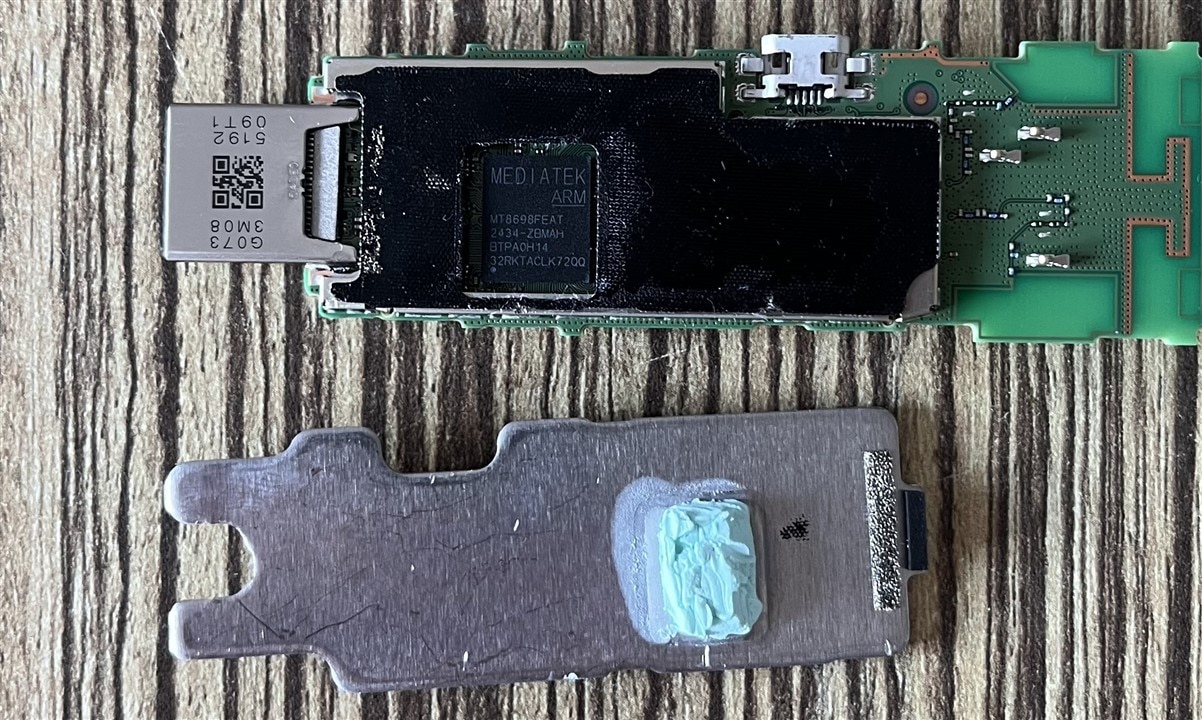

As we see, there is SoC: MT8698FEAT which is connected via thermal paste with an aluminum plate for better heat dissipation. Probably close to the SoC there is also an eMMC located. Here is a photo of the bottom side with the removed aluminum plate.

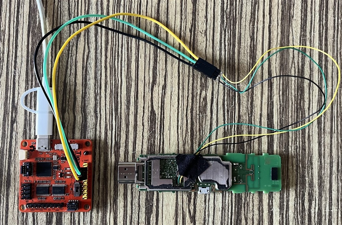

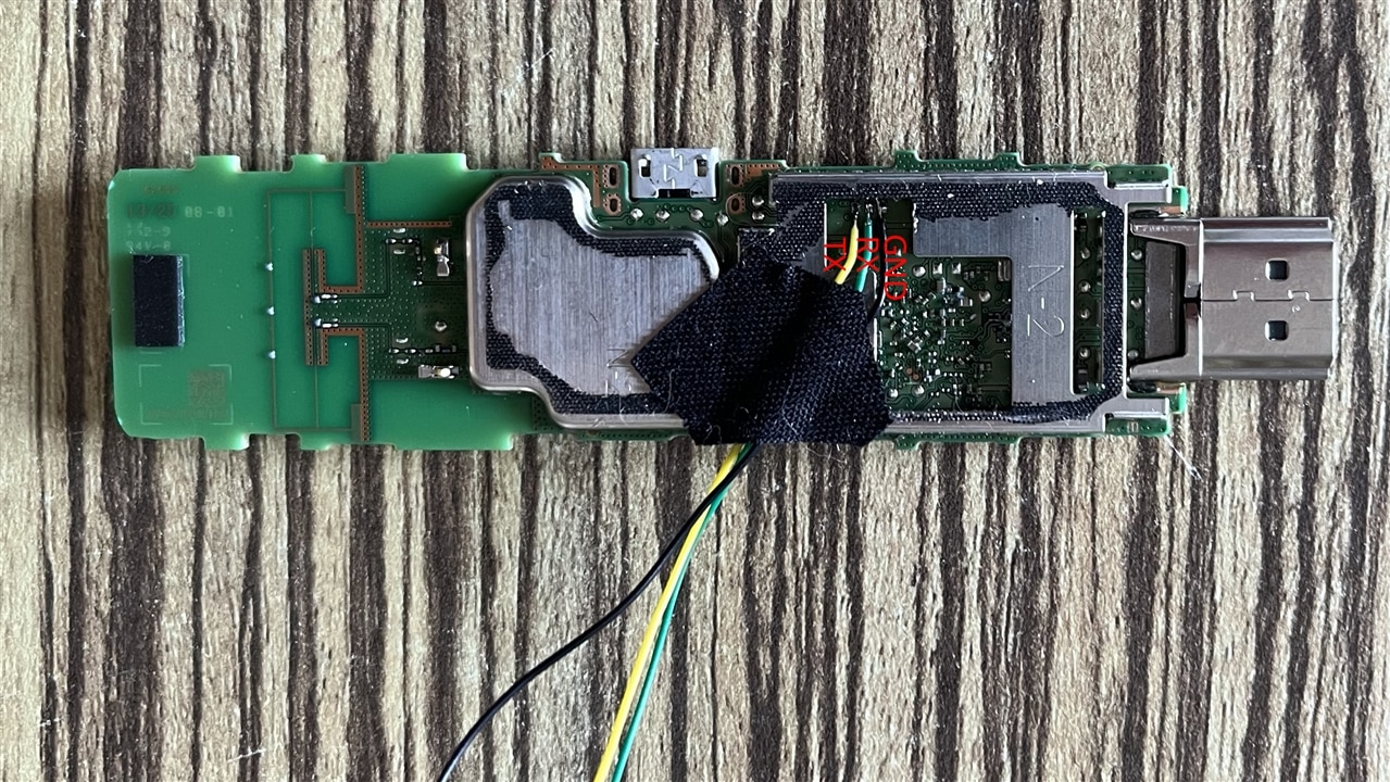

On the bottom side, there was also a thermal paste that transferred the heat from the PCB layer of the bottom of the SoC, to the aluminum plate. In the separate can, there is probably a Wi-Fi/BT chipset. I have also found three pins here that look interesting, so I decided to check with the logic analyzer if there is any data on them. After a while, I found that it was a UART with the following pinout.
The UART works with 921600 bps speed and collection logs of the boot procedure. There is also a login prompt (asks for login/password), but by default, probably disabled for security reasons. Here are attached boot logs:
