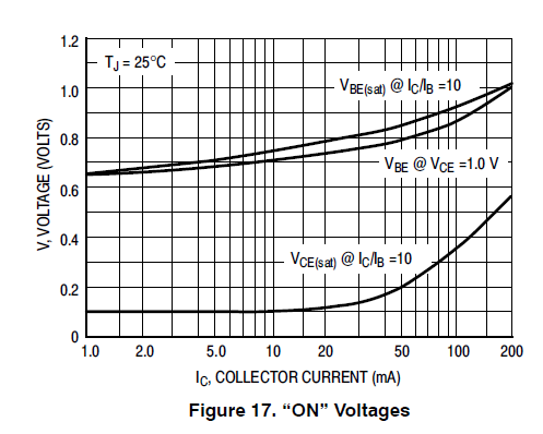

minimum gain that a large power transistor might have at high current, a figure of perhaps 40 or 50). Here's an example from a
2N3904 datasheet where they give indicative voltages for two different collector currents
They also give this handy graph and it's that that I'm going to have a go at replicating in the next section.
That graph is very useful because, as well as showing the Vbe(sat), they also give a second curve for the Vbe with the collector
held at 1V where the transistor is out of saturation. That shows us the difference the saturation makes. It also emphasises something
that I'm going to skate around here and that is that, at high currents, there is also an ohmic component from the bulk resistivity of the
semiconductor [at low currents, the Vbe voltage increases at about 60mV per decade of current (it should be a straight line on the
graph with its log scale for current), but at high currents it increases faster because of that additional factor]. The collector current
will also be affected by the same kind of ohmic effect.

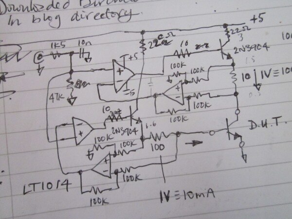

I'm now going to try measuring Vce(sat) and Vbe(sat) over a range of collector currents. Here's the simple circuit I've come up with.
There's a quad, precision op amp to run a constant current into each of the base and the collector. The respective currents will be in
the ratio 1:10 [the two current sources are identical except for the current-sense resistor which sets the relationship between the
voltage at the input and the current generated].
I'm going to have a 0V to 2V ramp from a function generator going in and adjust the oscilloscope so that it displays over the width of
the screen (I'm using the sync output from the generator to trigger the 'scope). The 2V input corresponds to 200mA in the collector
and 20mA in the base. That way the 'scope will draw the graph for me with the horizontal scale being equivalent to 0-200mA at the collector.

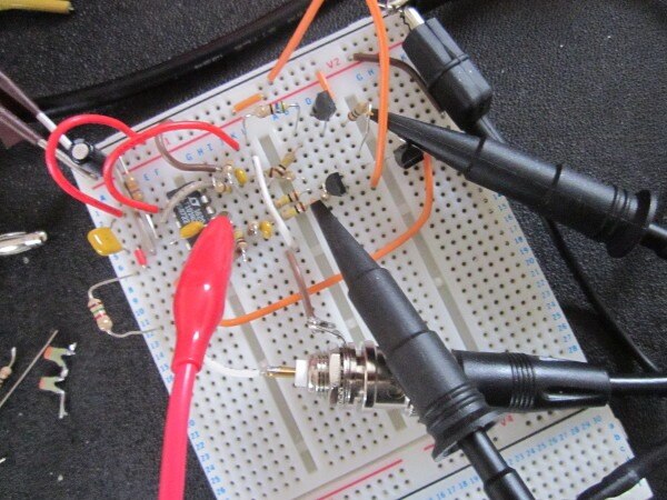

Here it is wired up on a breadboard (almost as messy as the circuit!):

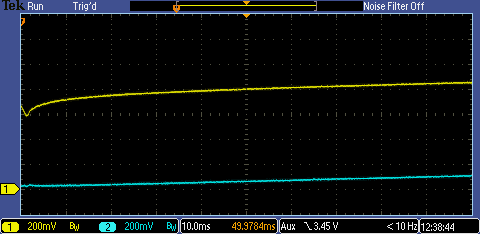

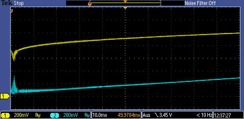

Here are the resulting curves for a 2N3904 transistor (yellow base voltage, blue collector voltage):
It wasn't all that stable. My function generator is noisy, which doesn't help. Including a simple RC filter at the input helped cut down the noise
going in. I also added capacitors across the feedback resistors to the differential amplifier outputs to compensate the op amps more. Something
else that helped was giving the amplifier a negative rail. In spite of that, the transistor hoots a bit under some circumstances but, if you ignore
the area up to about 20mA collector current (the first horizontal division), the rest looks reasonable. In the simulator it's stable, so I'm probably
looking at the way three rf transistors interact on a real, messy, plug-in breadboard.
The Vce(sat) extends from just below 100mV at 20mA up to just below 300mV at 200mA collector current. The Vbe(sat) is higher than you
would see for operation out of saturation and goes from about 800mV at 20mA collector current to just over a volt at 200mA.
My curve looks different to theirs, but that's largely due to my having a linear scale for the current - if you pick a few spot values and compare,
there's not too much difference. One important difference between the way I'm doing this test and the way a manufacturer would it is that they
use a pulse test where the transistor is only on for 2% of the time. That removes the temperature effects from the otherwise high dissipation
at the higher end of the scale.
Here are the results for a 2N30532N3053 part. This is a somewhat slower device (fT = 100MHz) and is much more stable on my test setup.
In this case, the Vce(sat) at 200mA collector current is much less, being slightly over 100mV. Vbe(sat) is also lower, being about 850mV.
